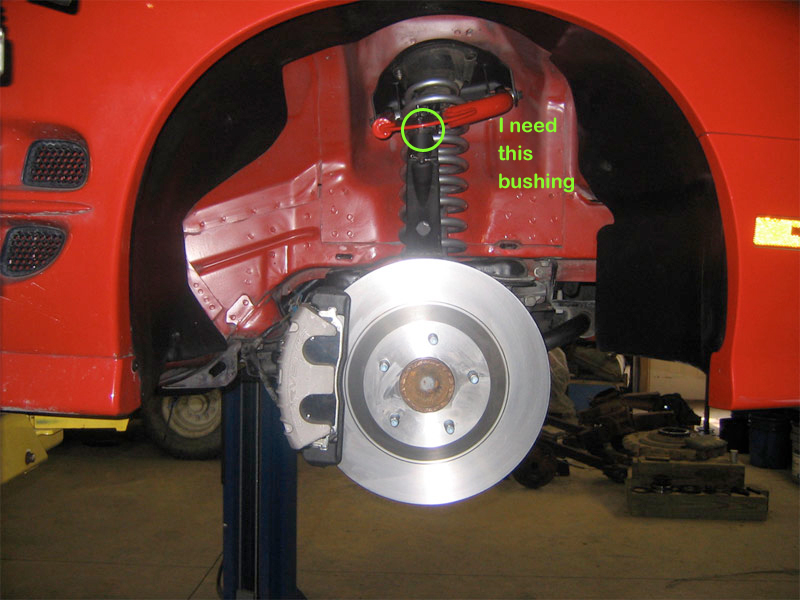

    Any one have a link or thread to a front upper and lower A-Arm bushing install?
    I skimmed the Haynes manual, and didn't really see anything that caught my eye for just the bushings.
    For the front upper what is the easiest way to get that bolt out? I'm assuming mine won't just fall out nice and easy.
    I don't even pay attention to the lowers. SO I have no clue what the setup looks like or where the bushings are.
    Thanks

    I was looking to see how hard it is to get the bushings out of the upper and lower A-Arm. A local shop mentioned pounding out the upper bolt. This makes me think mine is most likely in there very tight.
    I was looking for any tips or advice on the best way to replace the bushings.

    well, to do the upper arms, you'll have to remove the shock again... i know how much fun you've had with that. i use an air hammer to knock the old ones out. the lowers the same way. putting them in, i use ball joint/bushing press i have.
    yeah, but at least i don't have to compress the springs, .
    Hmm, that must be what the guy was referring too when he offered to pound them out.
    Are they in there that tight?
    And if I go poly, then what is that pre-lube stuff?
    Do you have to use specific lube on poly? I can't think of any poly items i have right now that need regular lubing. Even the bushings I am looking at in the future don't see to need lubing.
    I think I am missing something on this whole poly and lube.
