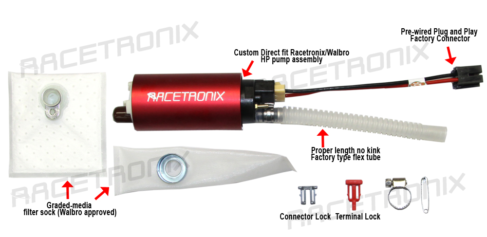

    What year is your car and what pump did you use? 98 metal tank cars can use any universal walbro. 99+ Plastic tank cars need to use a walbro with a venturi fitting like so.
    The venturi line needs to be hooked up to that brass fitting. Without it you will bleed off pressure as soon as the car keys offs and you'll have 1/4 fill tank issues.
