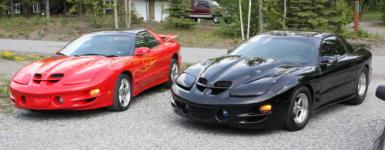

    2001 WS6 TA Red. Stock, 6 spd, LS7 clutch, Catback, Harris Nitrous Kit, Custom Painted Flames, Wolfe 6 point rollbar.
    1998 TA Black. 408, t350, nitro daves plate w/dedicated fuel cell, mini tubbed, 30" dr's. 9.75 @136mph on a small shot. Fastest LSX in Alaska, Pump gas, never trailered street car.
