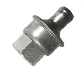

    Ok thanks guys. Only one problem, I dont know what or where a check valve is located. I tried looking it up in my repair manual but no luck. Any way u could show a picture of one or point me in the right direction?
    Member Fung Bucko's Avatar
    SC
    126
    2002 WS6
    Looks kind of like this. Its hooked to a tube from exhaust manifold and goes towards firewall. I think that's a good description, not at home right now. It should be black but the replacement I got was a brass color.
    22,144
    Had to replace both of ours in the fall due to a similar code. They were t-i-g-h-t! Ended up removing the tube from each manifold and had to use a heat wrench to break the valves loose.
    Be aware that there a couple of manufacturers of these valves -- I actually had 3 different styles show up at our local Autozone. They kept re-ordering until I had a matched set of the style that looked most like the stock valves. Therefore, you may want to order a set and replace them both.
