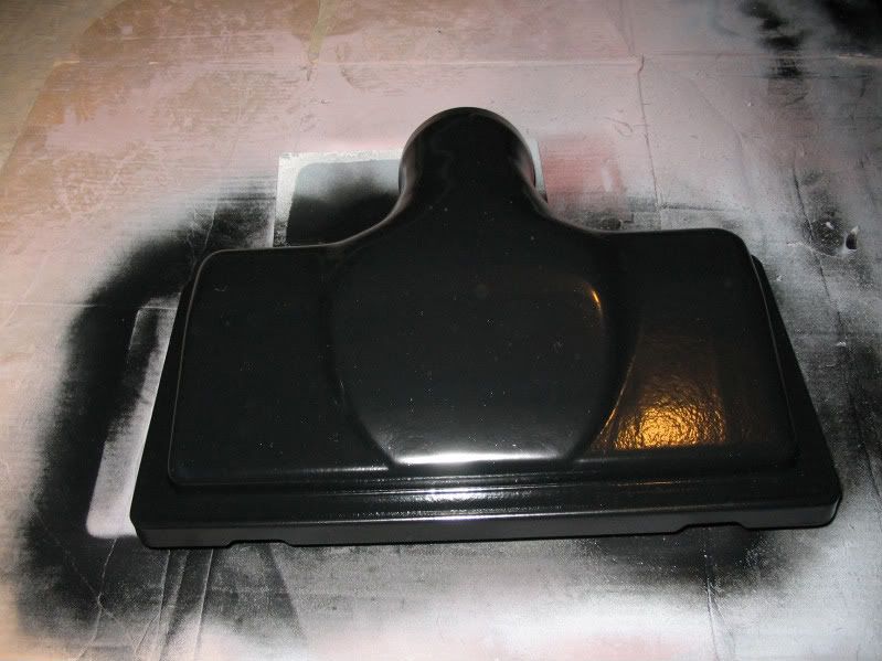

    Continuing my Smoothing and Painting streak (Tail Lights and FAST Intake), I took care of my new FTP Air Lid.
    I used Engine Enamel because it seems to be stronger than regular body paint

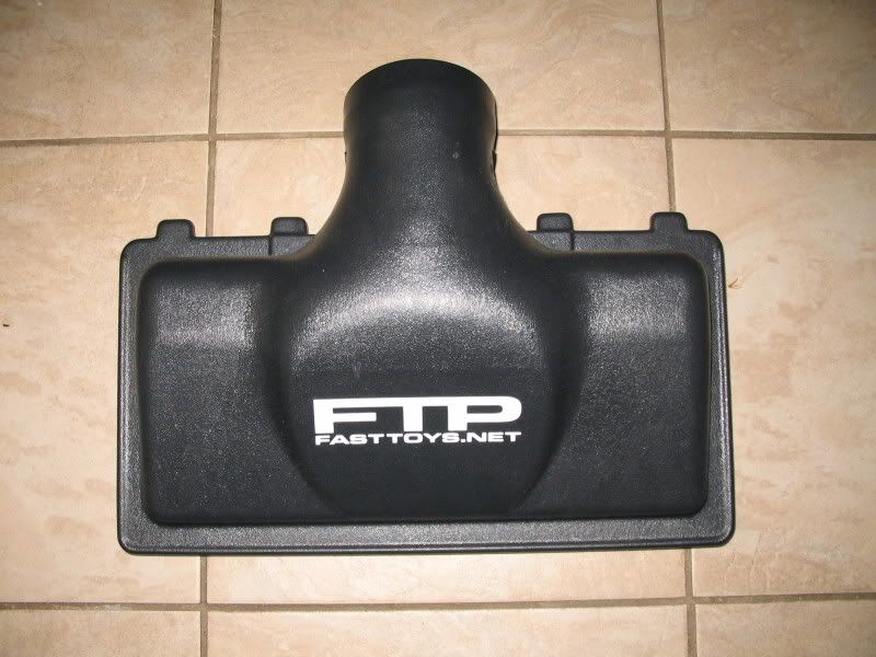

    Here is what I started with:

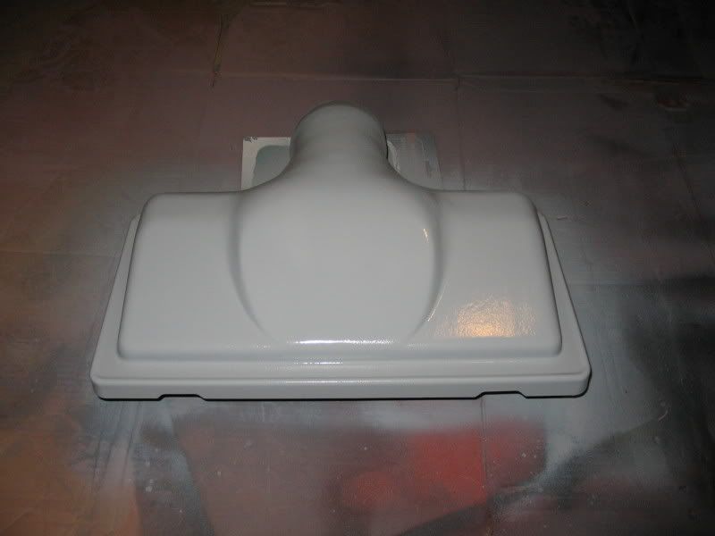

    Primered:

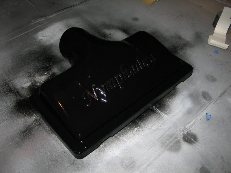

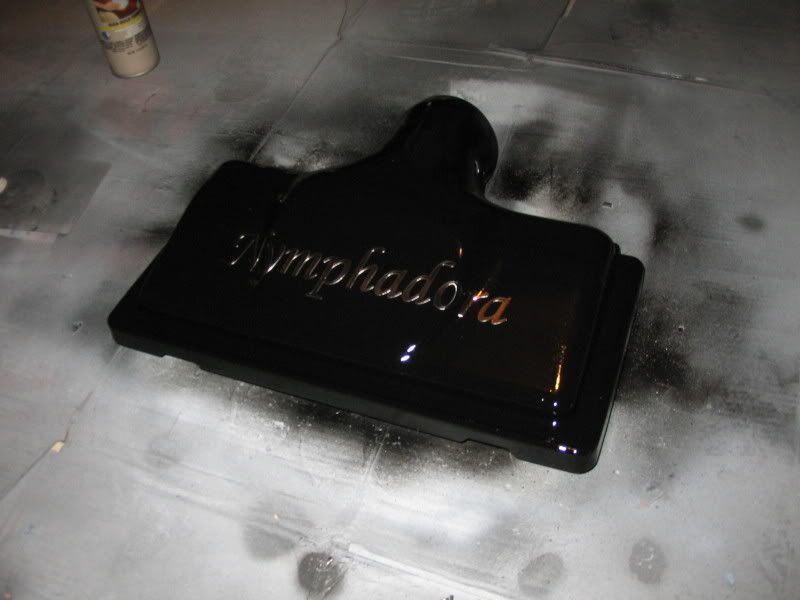

    Black Engine Enamel applied:

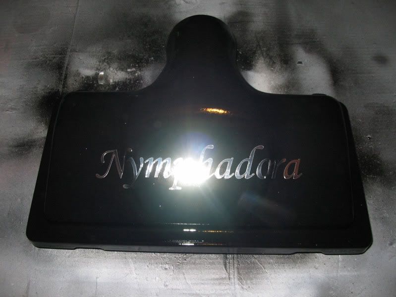

    Stickers and Clear Engine Enamel applied (over stickers):

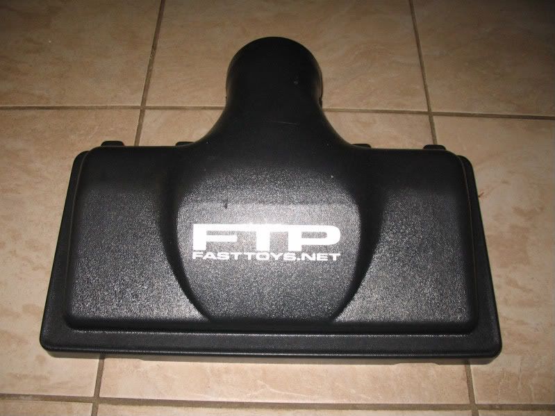

    Here is what I have on there now (UPD Air Lid...no paint, just stickers stright on the plastic):

    What did you use to sand it down?
    Laurel, Maryland
    4,975
    2000 Grand Prix GTP
    2000 Trans Am WS6 M6
    60 grit, then 100 grit sandpaper to get the plastic smooth, and then filler primer (best invention ever, just by the way) to fill in the scratches.
