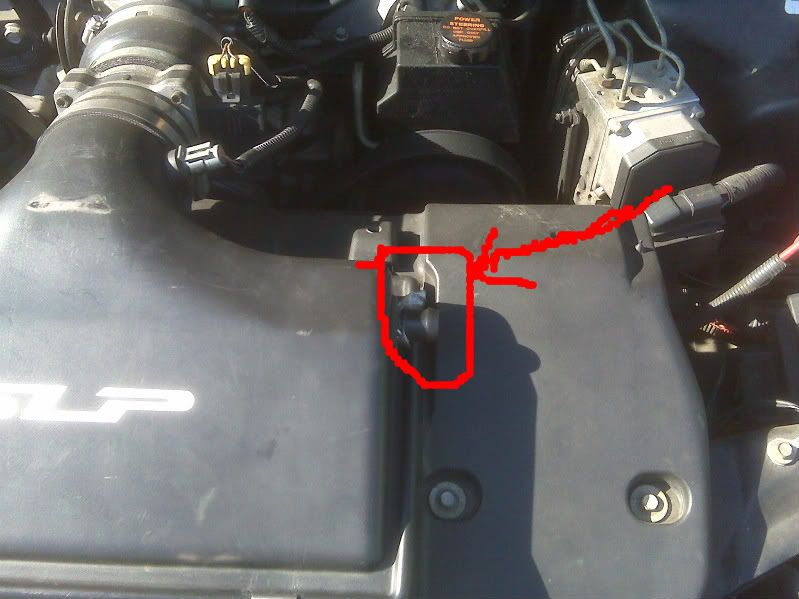

    I bought my 98 WS7 about a month ago and she's awesome. I do have a ? though. I noticed what appears to be a vacuum port on the airbox that's not connected to anything (see first pic below). She runs great but I can't help but wonder if she'd run better with this connected. Currently, it's got what appears to be a plastic baggy or cellophane covering the inside opening before it was put into the airbox. She's got the SLP lid and CAI if that matters
    close up of the airbox and the port in question

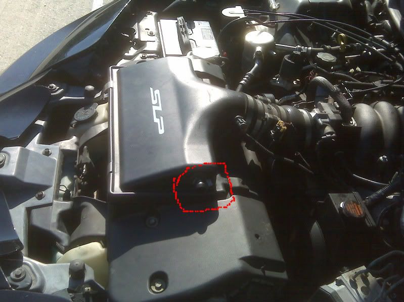

    side view of the port and airbox

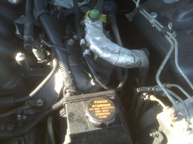

    Also, there's some hoses and wiring that are wrapped in some sort of silver tape that just doesn't look good to me
    Hoses behind the power steering pump, driver's side

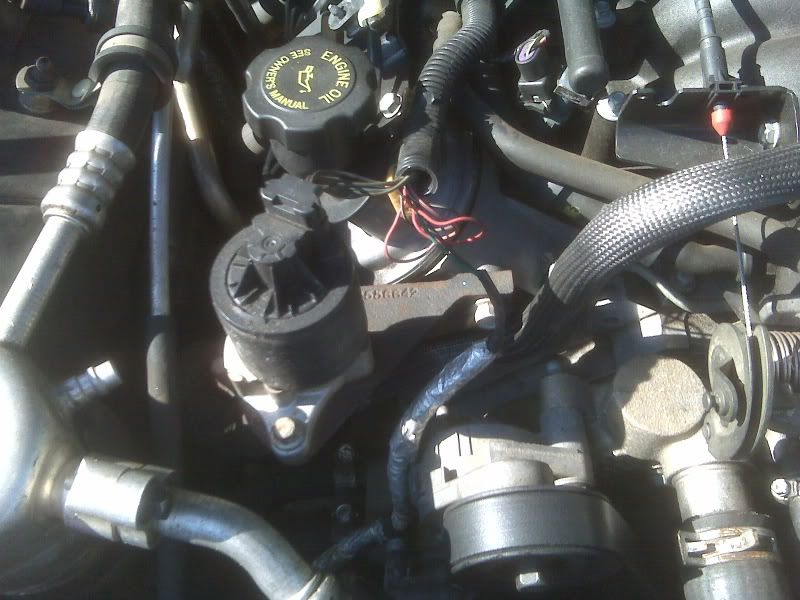

    Wiring in front of the oil cap, passenger side
    So I guess there's more than one question Do I need to connect that vacuum port (and if yes, where do I connect it?)? Is there a better looking sheath for the tubes and wires pictured or is that really it?

    As far as the silver tape covering the wires, that's actually factory. Mine has that too. I beleive it's heat shielding, since those are fuel lines.
    If you don't like the wiring, you can always buy more plastic conduit. It comes in different colors, Pep Boys and places like that carry it, as do Summit and Jegs.
    Mine also has a hose coming out of that spot on the lid, but to tell you the truth, without going out to look, I don't remember what it goes too. Might be part of the AIR system. IIRC the AIR pump is located in the lower part of the driver's side fender, below he headlight. That hose goes to that, I think.
    And congrats on the Bird!

    on the 98 and 99 models it just gets plugged up, it only goes somewhere on 00-02. I have 99 and mine came with a cap for it
    He nailed it.

    That is actually where a sensor goes that measures the air pressure in your airlid (the pressure goes up goes up the faster you go). Not sure if you really need it or not, probably not. My '98 has it, but I don't think it would be a problem if it were plugged.

    the port in the side of the air box is where the a.i.r. pump draws filtered air from. The 98's and 99's didn't have the filter line it so it was common for people to plug that if they got a lid for a 00+.
    The silver tape is stock as are your wires to your egr valve.

    As for the O.P., That port is for the A.I.R. system on the '01-'02 models (runs to a pump in the drivers outter bumper area, "behind the turn signal")
    Plug it up, as you are allowing trace amounts of UNFILTERED air into your engine...
    The Silver heat shrouding on your fuel lines (as mentioned) is stock.
    The E.G.R. wiring you show (Passenger side front of motor) can be tape or shrouded, but for performance sake, you may delete it.... remove the E.G.R., block off the exhuast port (I took my tube, chopsawed the bolting plate off flush, MIG welded the hole shut, ground smooth, and bolted it back in place; you can do the same for A.I.R. delete.) Use a 35mm rubber freezeplug (with tightening bolt in center) to plug the hole in the intake, and tape the wiring backout of site. This also makes for a cleaner looking engine bay, and allows you to install a "Custom Head Plate" for decoration.... I think LS1.com Member: Third_Shift|Studios Can Make You a personalized one, or there are many variations available.

    They just get capped on the 98-99 the 00-02 i think its for a pcv vent hose to connect to.

    the connector on the side of the lid is for the AIR pump. you should plug that hole since it would draw unfiltered air in. i just siliconed a body plug in to block it. and the silver tape is heat reflective tape on the fuel lines.

    Most lids you buy are year specific due to the A.I.R. system differences between the 98/99's and the 2000+ as mentioned earlier. Lids purchased for a 98 or 99 won't even have that extra port. It just looks like the wrong lid was purchased, but that is a simple fix by just plugging the hole. I had to plug the hole in the right side of my Volant as well.
