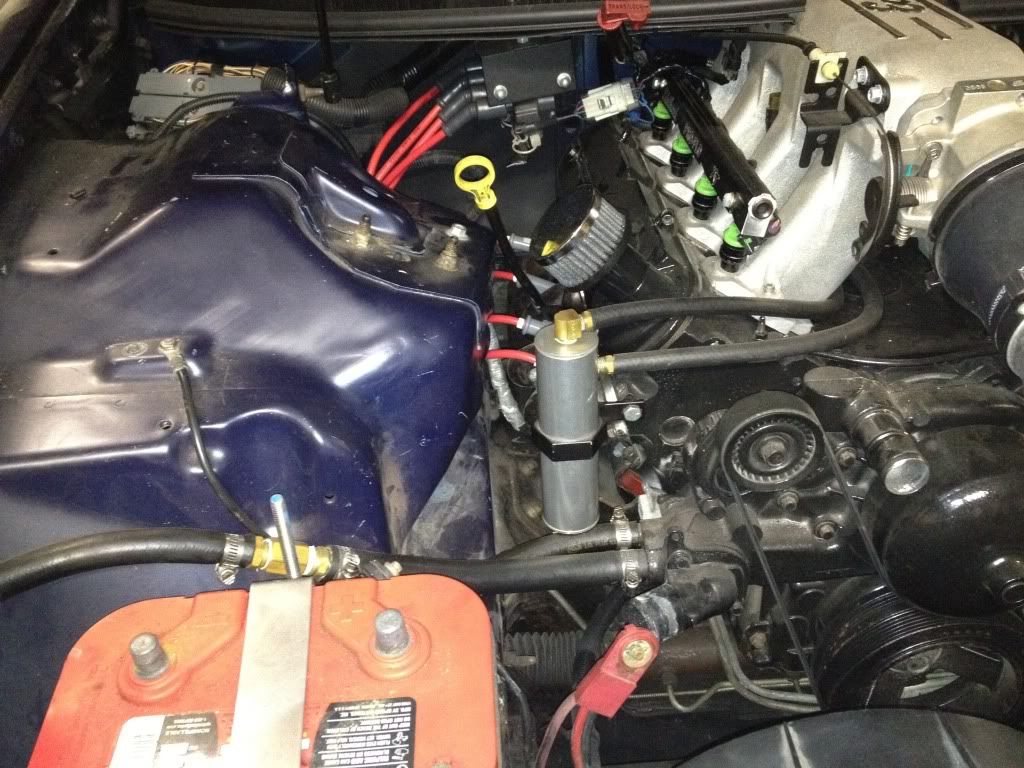

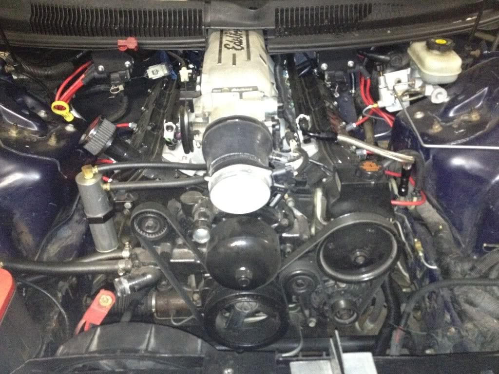

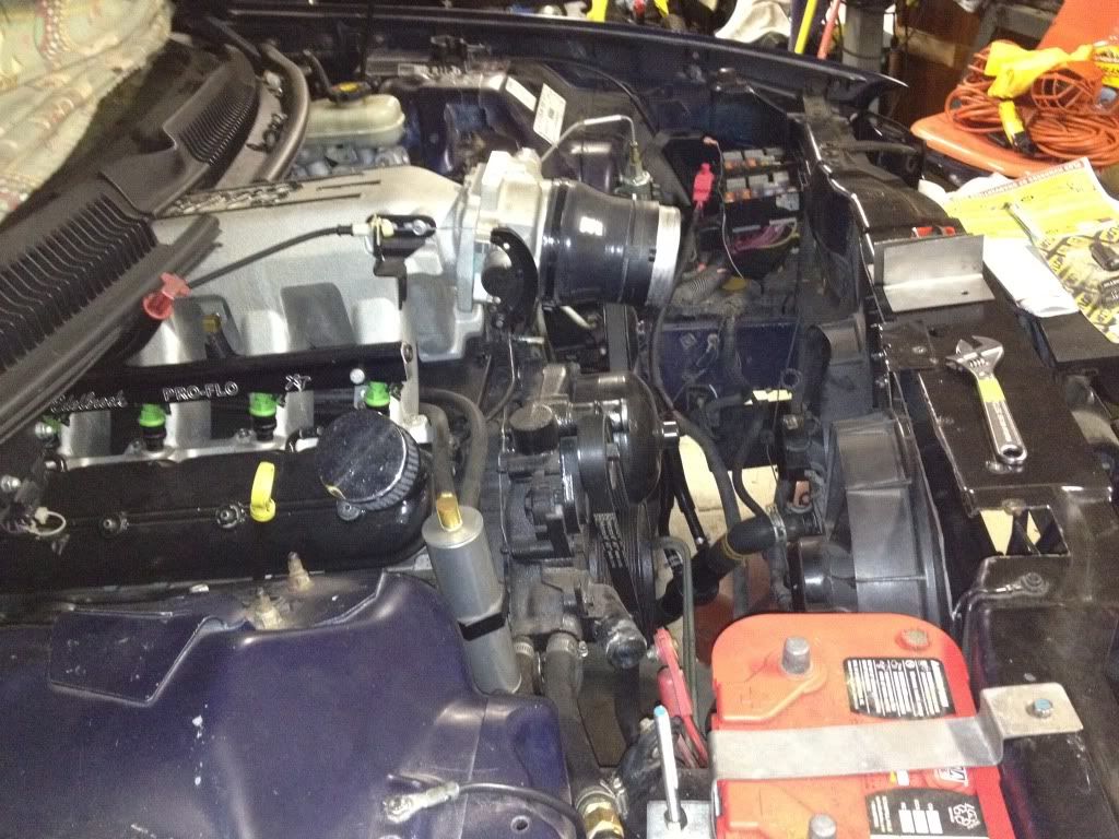

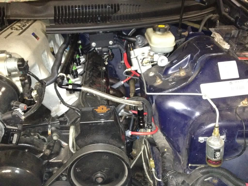

    I have done some engine bay clean up.
    I removed the entire ac/heater system
    Coil pack relocation
    Installed stand up griffin rad
    removed abs
    moved location of fuse boxes
    Shaved the stock valve covers smooth
    wire hide mod
    And I am sure there is more.
    I am not done but this gives you an idea of how far you can go:
