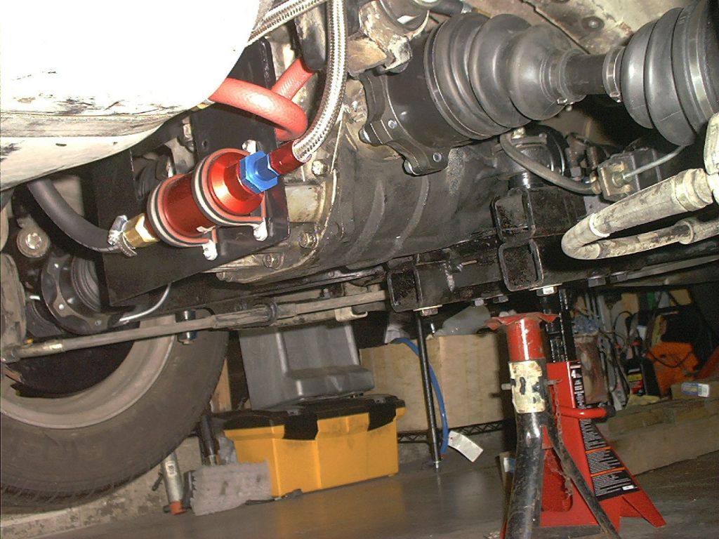

Its in a datsun 240z, but I am using the stock fuel rails with the regulator on it and the fuel rail has a return line. I am using a holley inline electric fuel pump that supposedly pumps at 100 psi.
Here are a couple pictures of my engine bay.
http://forums.hybridz.org/attachment...3&d=1204608427
http://forums.hybridz.org/attachment...4&d=1204608569
