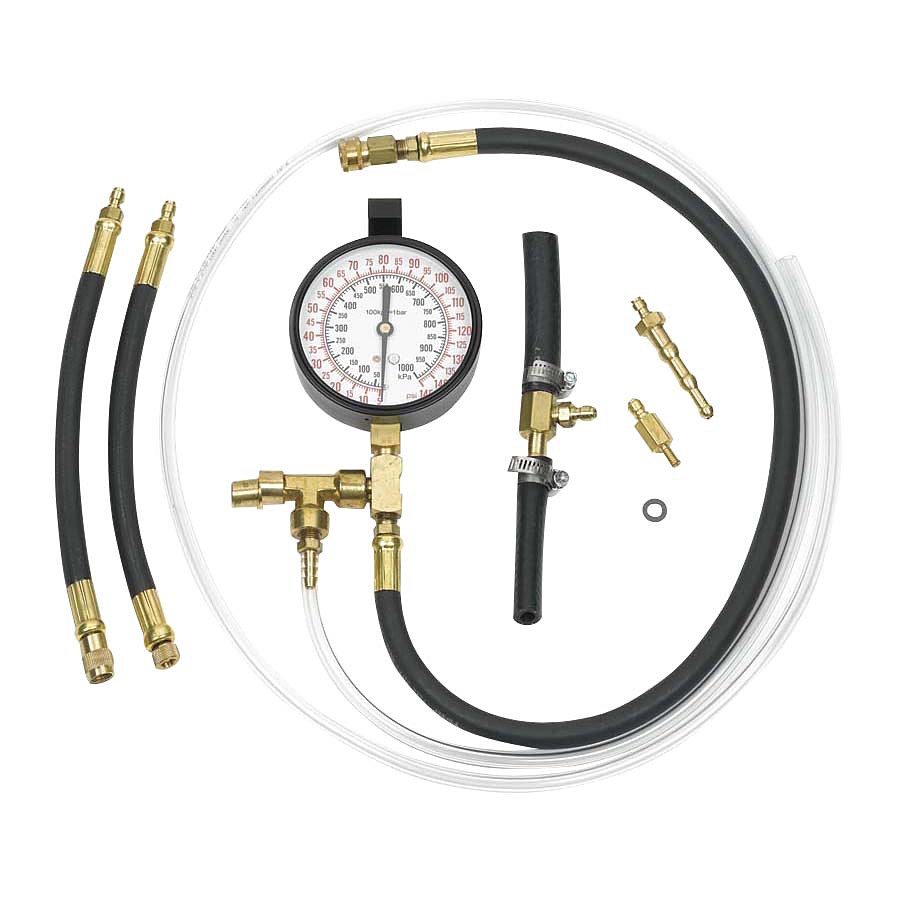

    so i just bout a fuel pressure tester kit and couldn't get any reading at all. I screwed it onto the shrader valve and had the clear tube stretched out into a small gas can. when i turned the car on, nothing happened on the gauge and when we moved the tester gas squirted out of where the tester connects to the valve (not between the shrader valve and the tester but just after the metal part of the tester that screws in). gas went everywhere so i shut off the car and called it a day. is there something i'm doing wrong? i want to make sure i still don't have a fuel problem before i go and get it tuned on tuesday!

    Did you get one like this KD tools one from sears with the quick connect for the different adapters? If so check at the quick connect areas to make sure everything is seat properly.I had one that the valve was slightly unscrewed and wouldn't properly depress the schrader valve inside.
