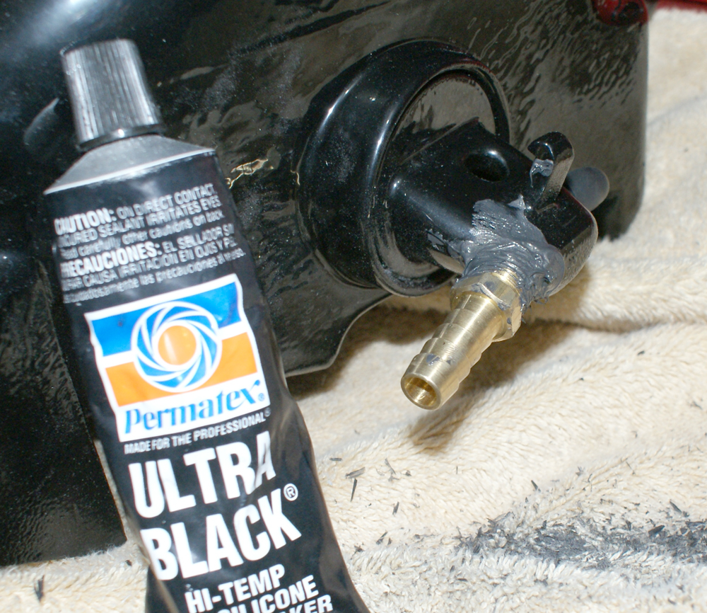

    here's what i did. JB weld a brass nipple into the existing section. should hold up fine.

    mine broke off the tabs where it twist into the manifold
