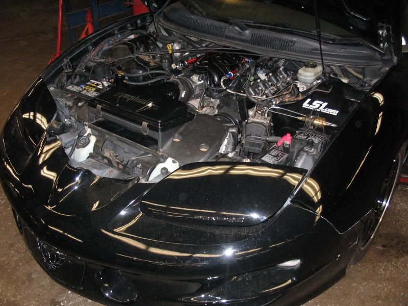

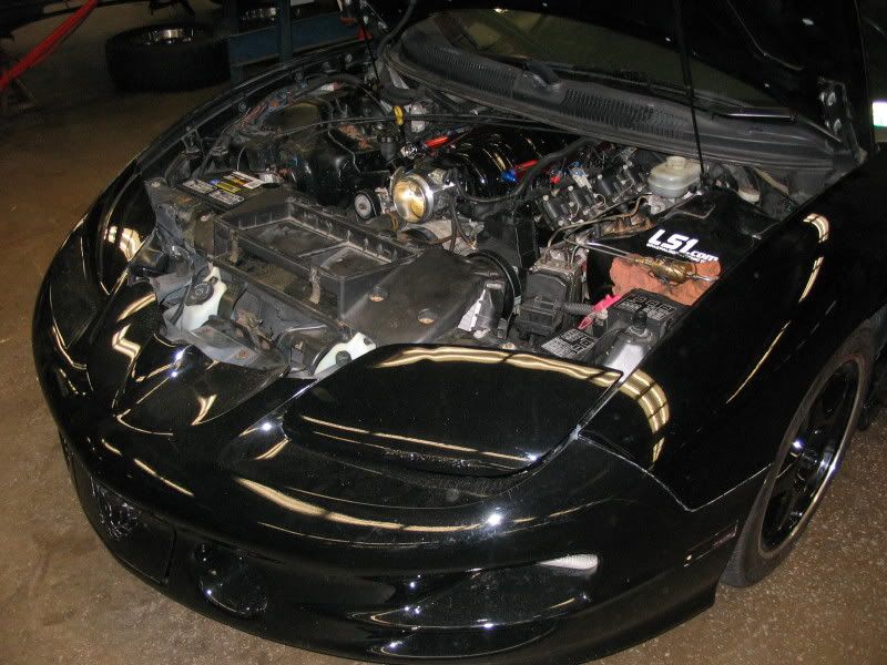

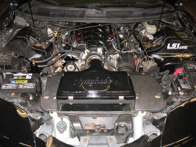

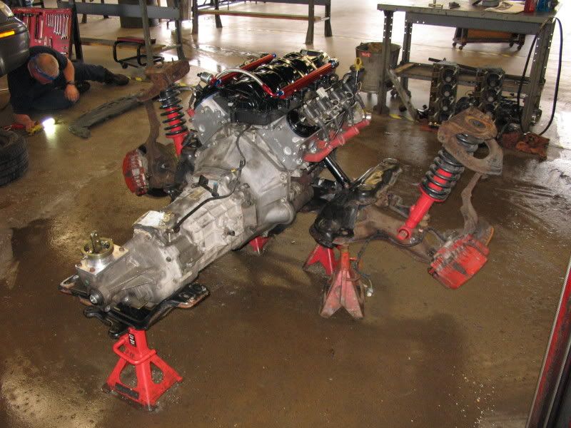

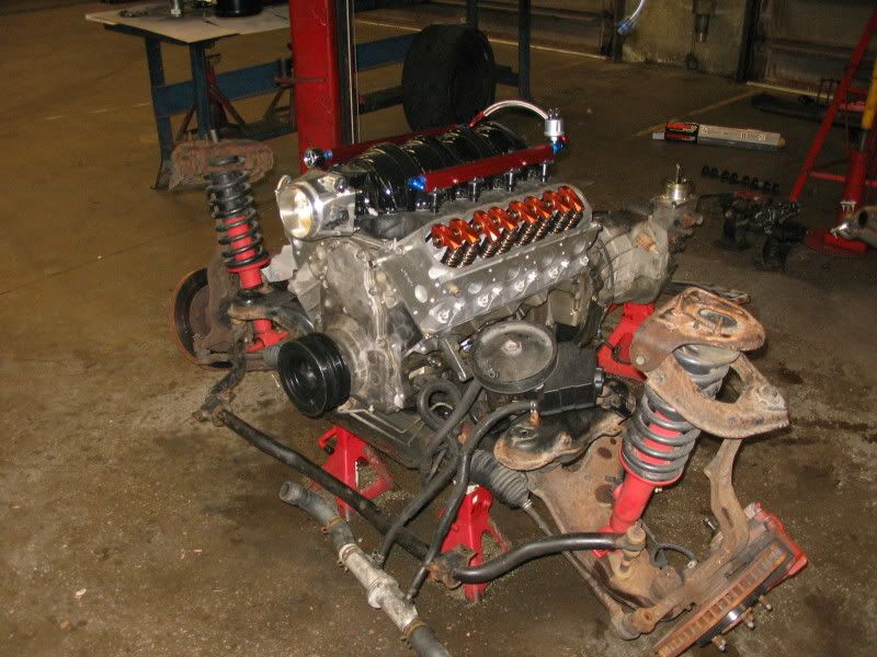

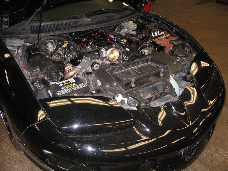

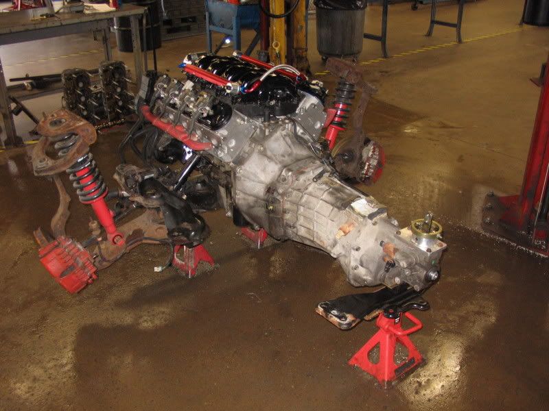

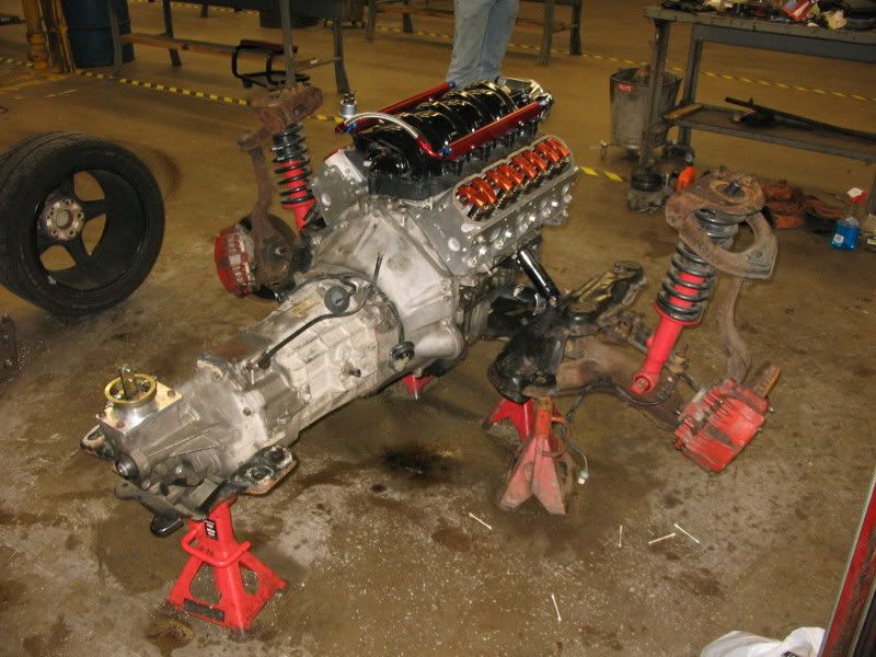

I started my H/C/I swap today at 1pm. It took longer than I wanted to get the motor out...oh well. I go back tomorrow at 1 to put another 8 hours of work into it.
04-29-2009, 07:31 PM #2
Wow! Looks like its going well... I like the last shot with the wire harness all dangling from the engine bay. What H/C/I is going on?
04-29-2009, 07:59 PM #3
04-29-2009, 08:17 PM #4
where are u doing that al kinda looks like a school or something

What shocks are those?
and
Are you going to take everything apart and paint it? lol

what kind of headers you got?

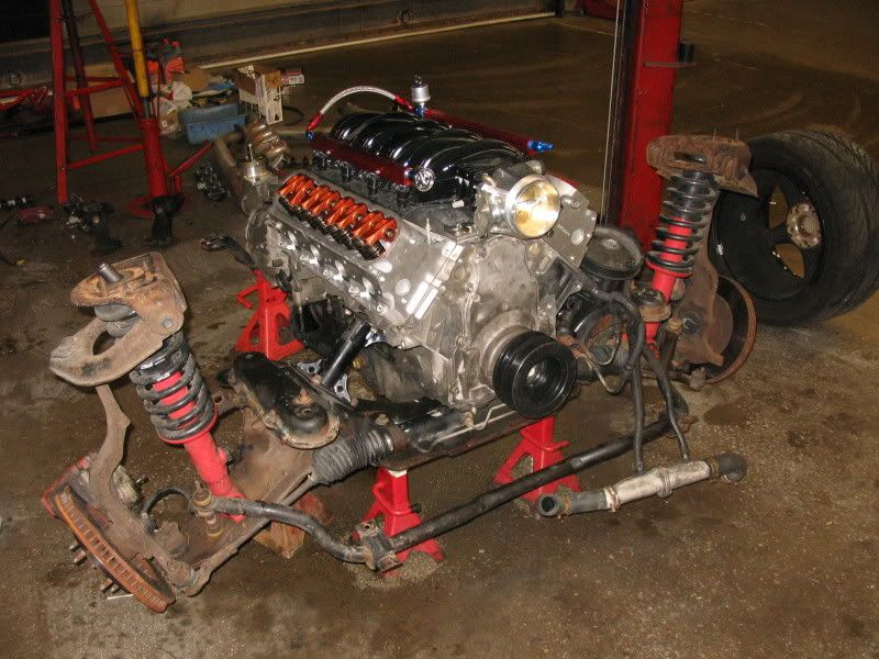

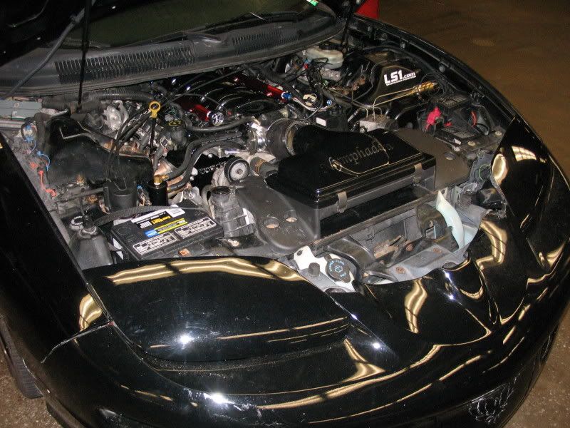

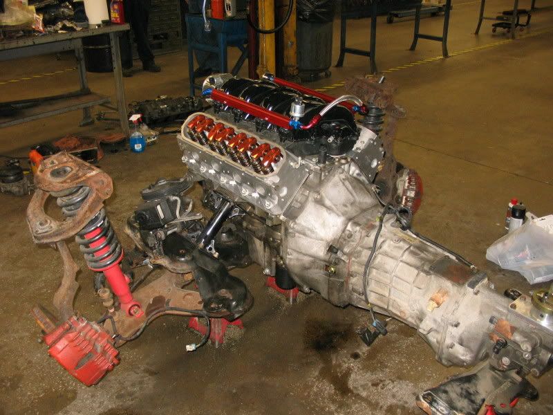

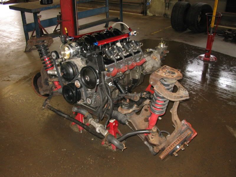

Here is my progress today...I spent a lot of time cleaning everything...makes it look like it's a new engine.
I also got the Solid Motor Mounts on.
Before the cleaning:
KYB AGX with Eibach Prokit (stock springs on the rear).
I'm painting the valve covers, and calipers tomorrow. I think I may spray a coat on the engine bay sometime before the engine goes in to cover where my wrenches have scratched the paint away.
7 hours...twice as long as I wanted. I also lost a K-Member bolt, I'm hoping it got kicked somewhere and it turns up soon.
Pacesetters...I don't have enough money at the moment to buy the LPPs I want. After I sell the stock heads and whatever else comes off the car, I'll be able to have some free cash to buy them.
Want my Pacesetters?

Looks good so far. What method did you use to clean the top of the pistons without getting all that carbon wedged in between the cylinder and the piston? Or did you take it all apart?
04-30-2009, 07:00 PM #16Sold: LS1 '85 El Camino
- Dec 2005
- Laurel, Maryland
- 4,975
Rotated the crank till two pistons where TDC and used a air powered gasket stripper on both the engine deck (where the head gasket material was) and the pistons (just rotated the crank a quarter turn till two more pistons were ready to be cleaned). I then took a shop rag and wiped all of the crud out of the cylinders when the pictons were at the bottom.
Question: Is it ok to mix coolant? I have a little bit of the green stuff left the block that I can't get out. Would it be fine when I'm done and adding the orange dexcool?

Cool, nice work on that. I dont see why not, if the green coolant you had in there was okay to use with all brands i dont think youd have a problem. When i replaced the stats on my cars, i just flushed the old coolant out but im sure we didnt get it all out. And ive been running the green stuff since then with no problems. But since its out of the car, theres no better time to try and get it all out if its possible.

Pull the plugs out of the block -- 17mm allen head plug above and behind where alternator sits and 5/16" allen head (may actually be metric, but this is what fit best) just above where the starter sits. Then flush it out with a hose like Joshie D said.
Looks great all cleaned up -- keep posting pics.
