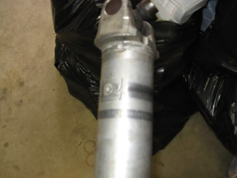

It appears something is rubbing/hitting my DS right here!

Sure seems like a driveshaft problem. Looks like something is rubbing right across the DS balance weight. It even looks like its starting wear the weight away. Could that be the rapid thud noise?
04-26-2009, 08:19 AM #3
Thats what I saw. The custom 4" exhaust goes right next to that point. You can see where they had to push the exhaust in to make it clear. It is starting to wear into the weight. Im hoping this is the thudthudthud. I might take it somehwere to check thr balance or order a new one/used one.

if the pipe is up against the DS, then that weight would slap up against it everytime it came around....makes sense to me

ahh yeah it makes sense. Maybe you bottomed out on the exhaust pipe and bent/pushed it closer to the driveshaft. If the DS was bent, it should vibrate all the time.
