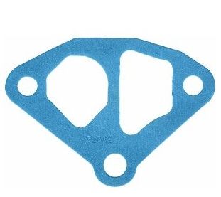

and that I should get this gasket along with it:
Fel-Pro 35635 Water Pump Gasket

i got an acdelco when i replaced mine works great and about the gaskets go to dealership for the metal gaskets there cheap and can be reused if wanted you will need two gaskets they are metal and rubber great pieces
ive used gm gaskets with everything and seems there better and will last longer imo

When I replaced the water pump on an 02 Suburban, the pump came with the metal/aluminum gaskets. Better than cork.

01-19-2013, 12:37 PM #11
Thse are picts of the gaskets and where you attach the h20 pump to the motor. You don't need to take the TB off. I did the job in about 2 hours but I was being slow.
