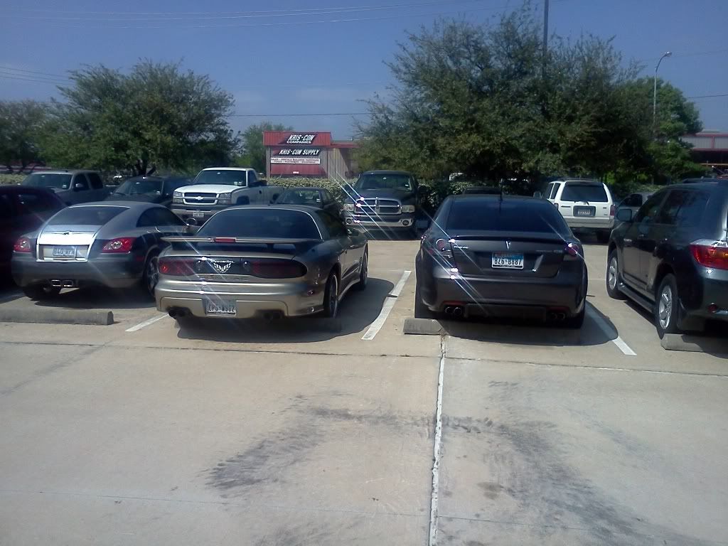

I've found that stock rubber likes higher air pressures. Lower pressures tend to cup the middle of the tire, less contact,,,especially on these wider radial tires. You can experiment by leaving short marks on clean pavement. Look closely at how even the mark is accross the entire contact patch.
Light in the center means it needs more air pressure. When it's even,,,it's a good starting point for the track when you get there. I found 40 psi to work exceptionally well on the 275/40-17's. Even the old bias plys I use like alot of air as well. From there it's all weight bias and sneaky suspension tricks. We weren't allowed any obvious weight bias, so we would put water in the spare tire. Sometimes even a larger spare tire than what the car was actually running to hold more water, or run the spare with a 7" rim instead of the 6" rims on the car, again more room for water. That's about as far as I ever went with weight bias in the stock class. Got me a best of 1.87 60 foot times on F70-14 bias plys :rotfl:
