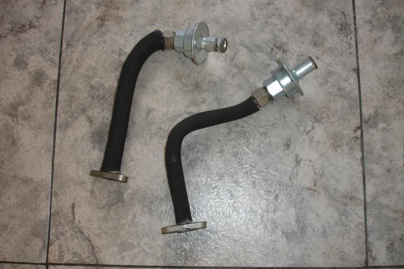

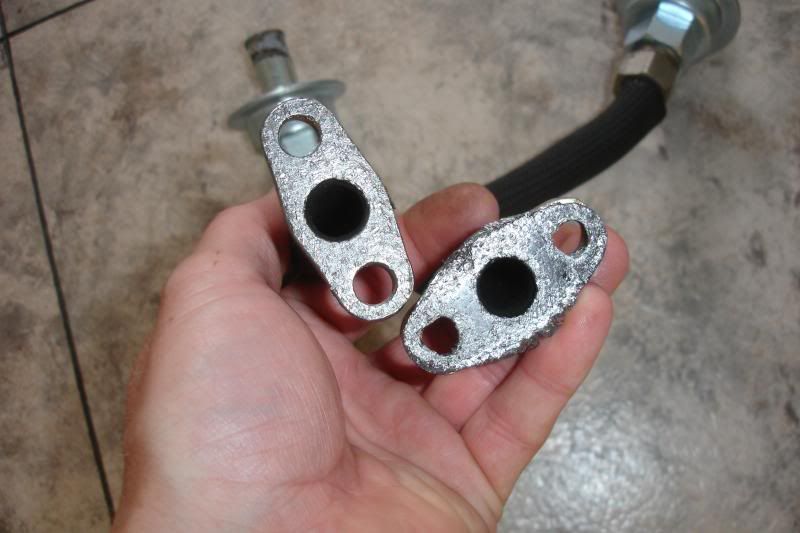

4. If the pump is running correctly and you have air at the driver side hose over the wheel well, then you need to check if the air is flowing to the exhaust manifolds. On each side of the engine there is a tube bolted to the manifold. This runs up to the check valve onto which is clamped a rubber hose. Disconnect each clamp and pull the hose. Again, on cold start up you should have air blowing from the hoses.

7. If all of these components are working correctly, then the most likely culprit is that the check valves or manifold tubes are bad, or simply plugged up. The check valves can be purchased from a dealership or most auto parts stores. The tubes can be cleaned of carbon buildup should this be the problem.
