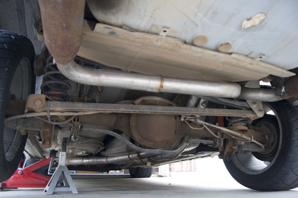

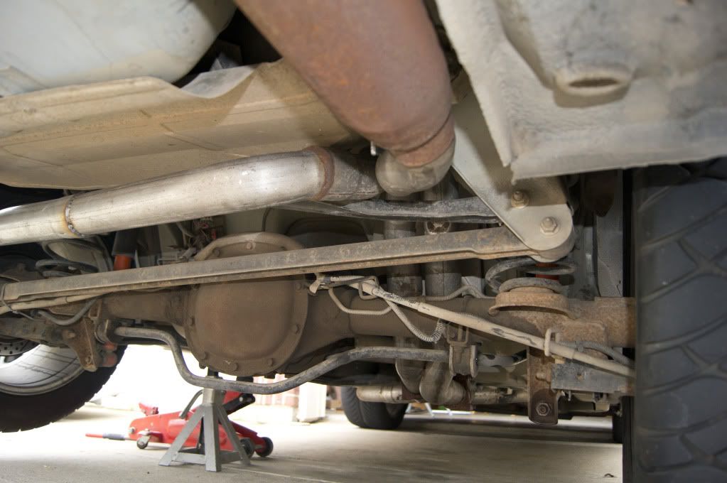

its not too hard to get 3inch duals over axle, get panhard bar relocation kit and youll be good. its tight for sure but its possilbe hell i have and everyone that has them over axle has to. I also got mandrel bent 90 degree bends to put up there and the work great. ill try and post some pics sometime soon i been needing to
