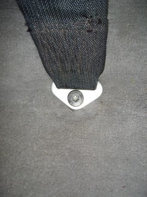

    The Harnesses were straight forward as I used the existing mounts for the lap belts, wrapped the shoulder harnesses around the roll bar and only had to drill two holes for the sub belt (crotch strap). I used the supplied hardware and existing bolts:
