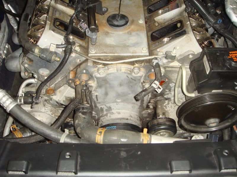

In the mean time, I started taking everything apart, As of now, I have the stock heads removed and started cleaning up the block so when the heads actually do come, I can slap them on and finish this project. I still have to clean all the gunk out of bolt hole, but its coming along.

What sensor is this? I broke it, Its on the driver side head towards the front of the car?

that is the coolant temp sensor.
02-02-2008, 09:41 PM #3
Beautiful car,bro! Good luck on the install. That does look like the coolint sending unit.
02-02-2008, 11:18 PM #4
While you're waiting spend some time getting that block as clean as possible. I got all the graphite off of mine. Don't nick the block though, I used a plastic ice scraper and a plastic dish scrubbing whatchamacallit. I even used some scotch brite type pads although you aren't supposed to use those because if the scotch brite particles get into your oil it'll ruin your bearings. I just used them very sparingly and made sure not to get the crap into the cylinders. It took a long ass time it seemed like but it all came off. Double, triple, and quadruple clean those bolt holes. My wife is a nurse and brought me home some of those long ass que-tips on the wooden sticks. Worked great. Find a medical supply place or stop by a dentists office and try to buy you a few of them.

Yep you need to clean that surface where the head gasket was.. it looks like its still on it.. I would clean that up and use a scraper that doesn't scratch the block or put deep scratches.. you can use a die grinder if you want just make sure you use the pad for almunium. Until the mean time keep it covered and make sure nothing falls in the cylinders. put like some rags and you should be good to go.. Let me know how it turns out...

Yea, I know I still have to clean it up, I used a scraper already and it actually feels smooth but I still have to clean it up. I have a good 2-3 weeks till I will see the heads, There was a mix-up w/ the order. But they were good about it and gave me free shipping for the misunderstanding. So i have plenty of time to clean the block up

It's a good idea to take a wet/dry vac and suck all of the coolant out of the bolt holes before installing the heads, to keep from cracking the block when torquing them down.

Looking at your pics I think your oil sending unit broke. Could just be the angle of the pic. Might want to check it out, I would hate to have you put it back together and find it the bad way.

Well I got my heads today! They must have rushed them to me or something. Good call on the oil sending unit, its def. broke I will have to pick up a new one. Also...is this the air pump? And do I need to put it back on?

No that's not the air pump, it should be driver side tucked in the fender. It does connect to the air pump if i'm not mistaken because it is part of the emissions system.
02-08-2008, 06:24 PM #13
that's the newer style air system versus my 98. If memory serves me correctly you have to cap that vacuum port if you take that off. Don't quote me on that though. If you're not running your air system then pull it all out and clean up the engine bay while losing a few pounds.

Another thing the oil pressure sending unit that you broke is common when taking out the intake. The GM part# is 12562267 the cheapest price i've found is on GMpartsdirect.com for $34, but you can get one at your local parts store for a little bit more. Hope this helps a little.

Car is starting to get put back together. Spent the afternoon cleaning out the bolt holes w/ the long q-tips orion recommended and it worked really well. I wrapped some paper towel around the q-tips so it absorbed more coolant. After that I put the new heads on and torqued them down, in the next couple of days when I have time I will begin putting the valve-train and everything else back together and cross my fingers she fires up

and the new oil sending unit that you guys noticed i broke
found one at an auto parts store for $40
