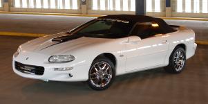

    I have a 2000 Camaro LS1, and am thinking about buying a LS6 intake manifold. Which one is the "best buy for the buck" ?
    I work at a GM dealership, and can get the LS6 manifold for $463, but it won't be compatible with the 2000 EGR. Can the EGR be deleted without setting a DTC?
    Should I buy the SLP LS6 manifold, with all hardware for $499.95?
    What do you guys suggest?
