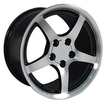

    here is the rims I got
    something simple, but will look nice once on

    Thats a replica wheel, correct? If I remember right, a factory wheel in that style for 17 inch wheels is only 8.5 wide.
    a P285/40ZR17 would look best but you could also do P275/40ZR17's as well.
    Yes replica rim
