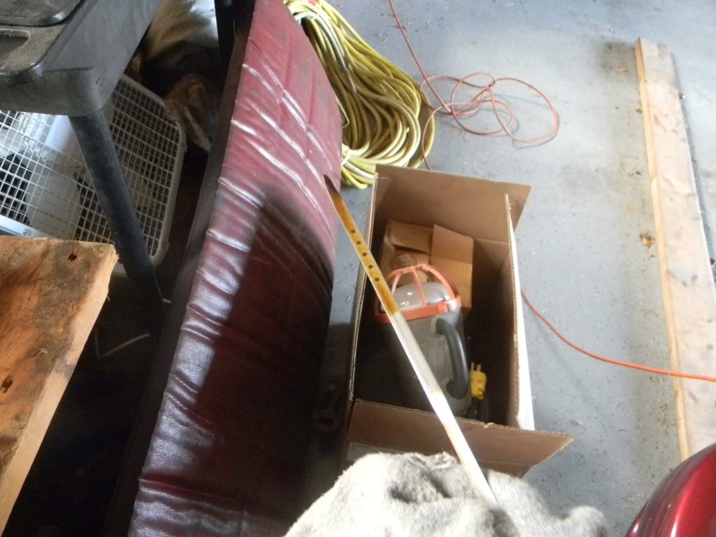

Heres the dipstick

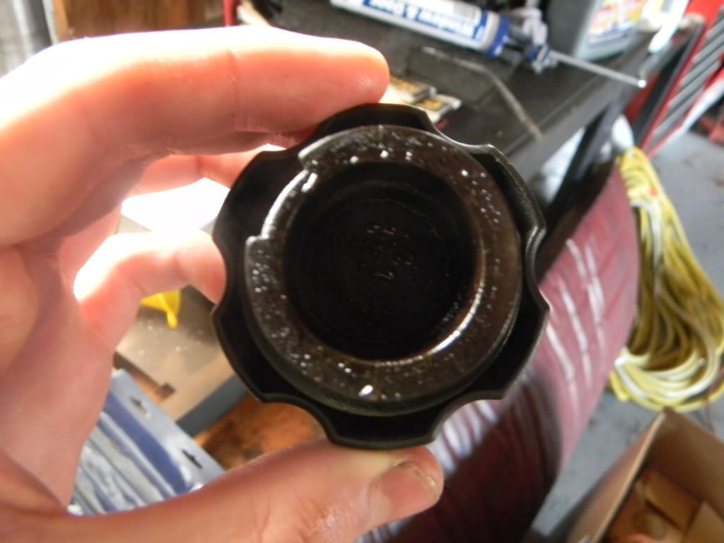

Heres the top of the oil fill cap, it looks like it has water on it

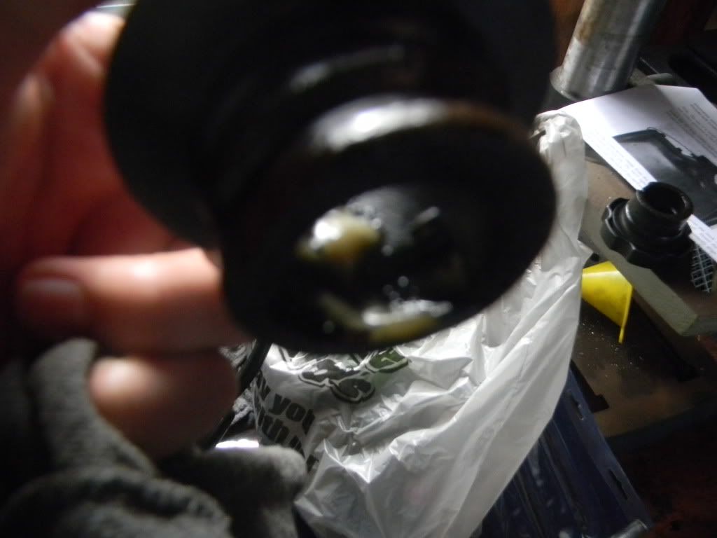

Heres the gunk on the inside of the oil fill tube

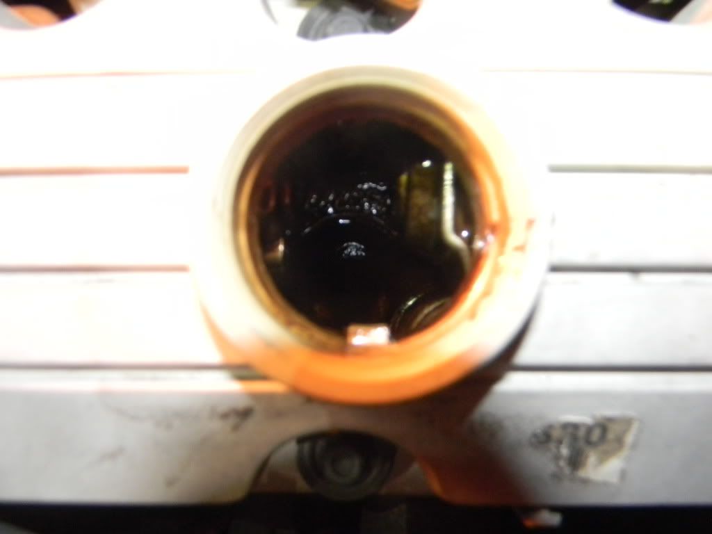

Heres the inside of the valve cover

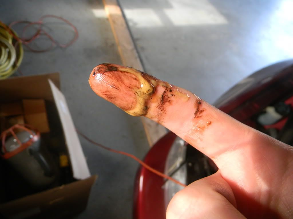

And heres what is in the oil of the valvetrain when i stuck my finger into the valve cover
