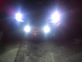

    check out my hid for headlights..custom made...myself

    Great Job, looks badass. How did you do it? Im looking to get it done on my TA though I wont see it for another 13 months...

    Looks good, bright as hell. If you have a breakdown of your method and cost that would be great to share.

    you can buy pre-made rectangular sealed beam HID headlights, just google search for them.
    if he really 'custom' made his I would be curious as to how he did it too.

    pre sealed beams are about 200 to 300 and probably dont fit i looked everywhere.i made these from beams u buy at autozone for 12 bucks and modified them.

    how? did you pull the white rubber off of the back of the stock housing, pull the stock filament out and mould the new HID into it or....?

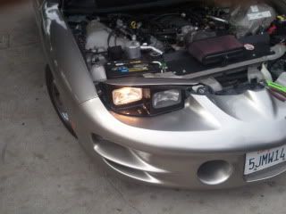

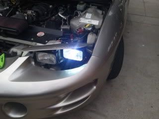

    Quote Originally Posted by tripps View Post
    I did the same thing to mine. You can cut the white rubber off with a razor blade. Under the rubber is one small screw, take it out and out comes the bulb. Then you just replace it with an H1 HID bulb, it's a direct fit. Put the screw back in and then put some silicone around it.

    Quote Originally Posted by 01ls1ws6 View Post
    did you just splice the plug wires or..? how did you get get them power?
    No you just plug the new bulb into the ballast... and then you plug the wires from the ballast into the original plug for the stock headlights. I just bought those small flat connectors, they plugged in perfect. I dont know what you call those connectors though, just know what they look like.
    edit: or rather the 'male' side of these.. which is just a flat tab basically, can't find a pic but I have a whole bunch laying around
    correct, then all you need is a tester to find the + and ground
