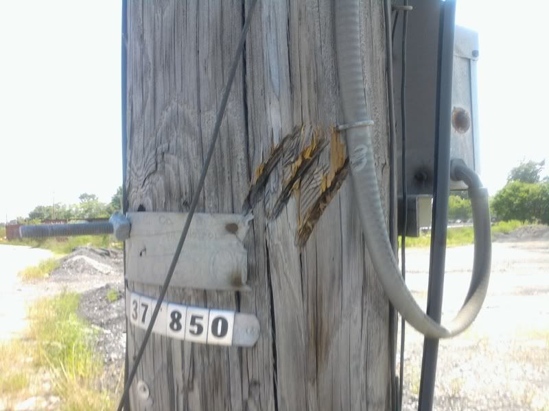

    So we go back to check out if that is indeed my crank pulley. We find it right by the telephone pole. Here is the pole:

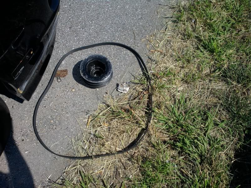

    And the pulley (belt was found not far from the crank pulley):

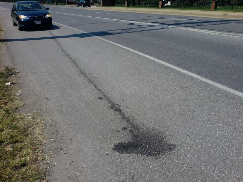

    More pics...oil that came out of the crank seal:

    The fastener/washer that holds your tensioner pulley looks like its been used and abused.
    I think it's just the lighting...it's the stock tensioner. I have a Katech one at my house, I just need to find it (got lost in the move).
