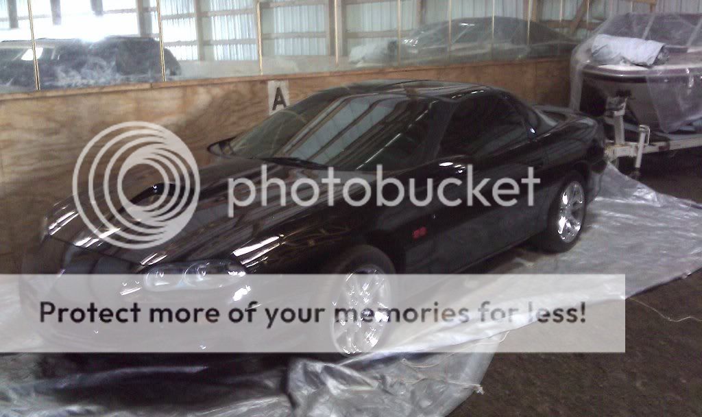

    No responses? no help? C'mon guys, maybe a pic would help....
    (taken from my cell)
