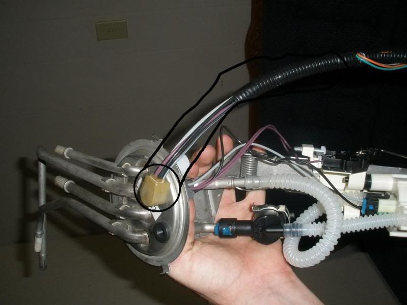

    Looks good but i think there are differences in the 4th gen between fuel pumps. My sending unit on my 98 has the extended lines, unlike the 2nd post where they just disconnect right there.
