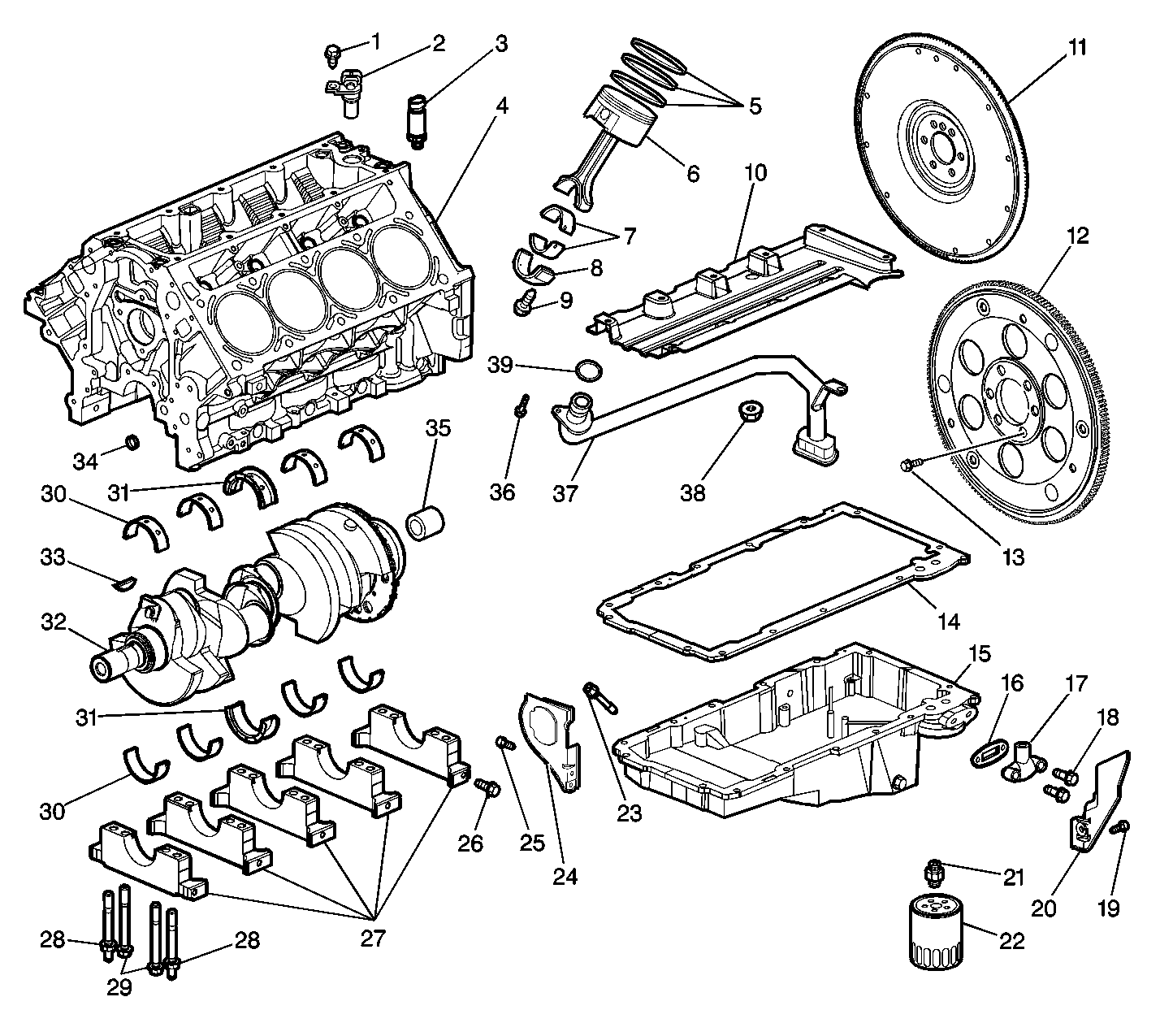

Hey Guys i have a 2001 Firebird Formula LS1 and i have a oil leak that is driving me crazy. i think it's the gasket around the oil filter adaptor where it bolts to the block. (if not its the oil pan gasket or maybe both. i've tightened both back up a few times and it seems to get better but only for awhile.)
what is that gasket called? the boys at AZ and advance auto can't find it anywhere in the parts books.
I thought it was a called the oil filter adaptor gasket but no dice.

Sounds like a dealer part only-service manual calls it "oil pan transfer cover gasket".You might try GMpartsdirect.com

nah, an oil filter adaptor gasket is under pressure and would blow out past the RTV.

Number 16????

yep, thats it now if i can find this part i'm good to go.
i don't think RTV would work to much pressure and i'd be afraid of it blowing out.
