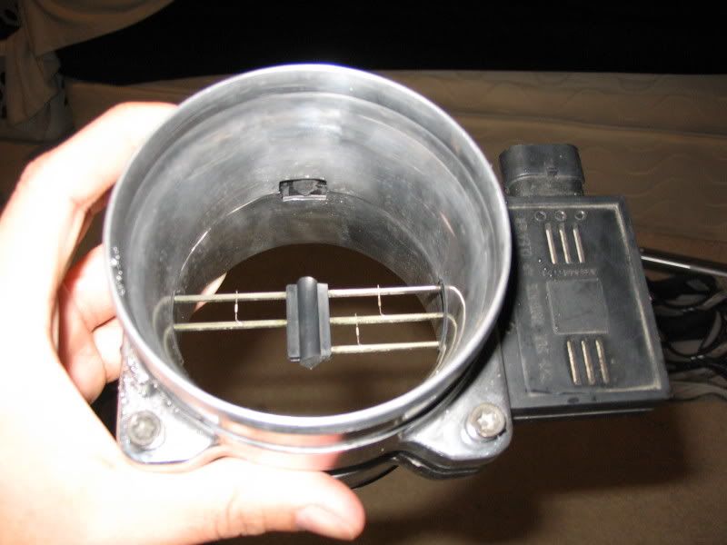

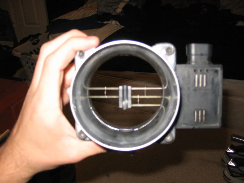

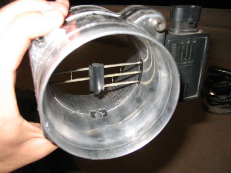

    I should post pics of my MAF...it was debladed/descreened by the previous owner and was tuned when he got headers and a lid installed. Last fall, I decided to clean up the hack-job that was the deblading of the MAF by the previous owner. I took my dremel with a 120 grit sanding wheel on it and "ported" the ends smooth and polished it smooth with Mother Mag Polish. The ONLY reason I did this is because the previous owner had it tuned after he messed with it.

    The before pics are on my dead desktop...here are the after pics.
