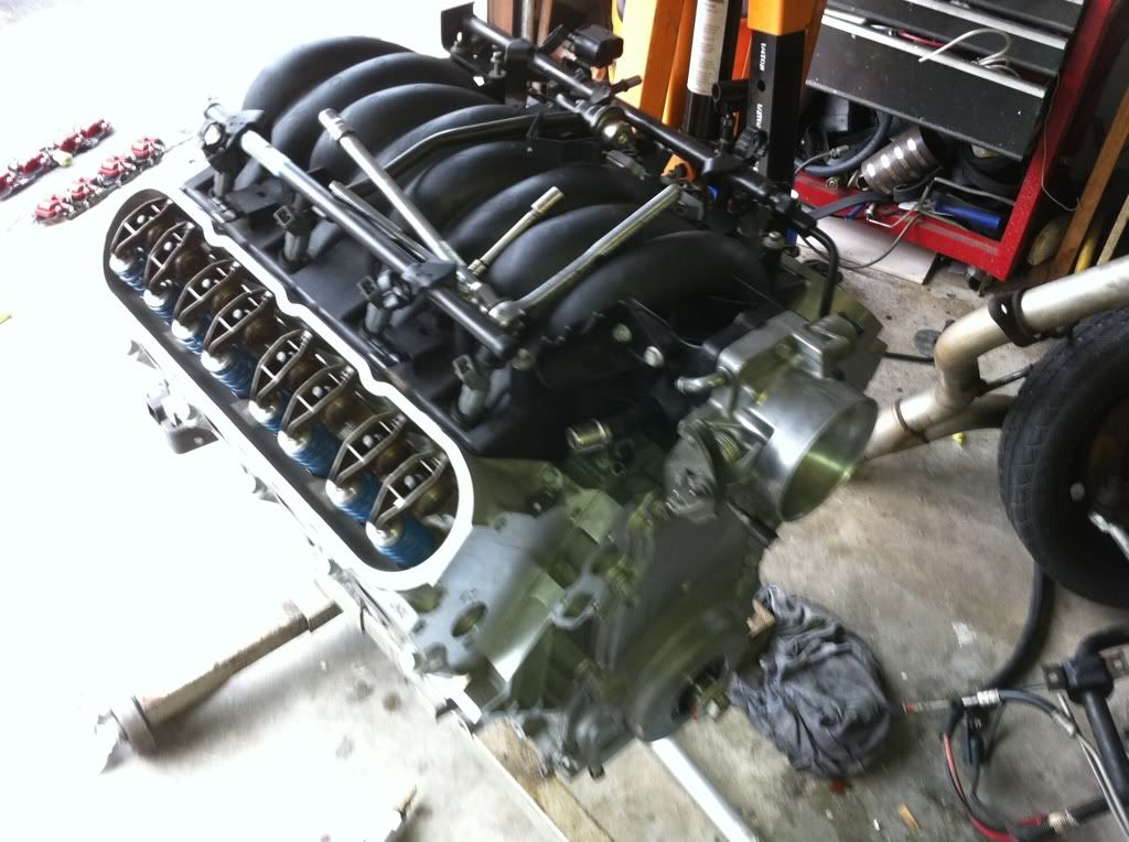

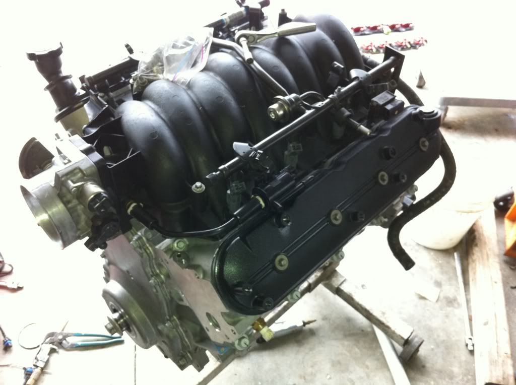

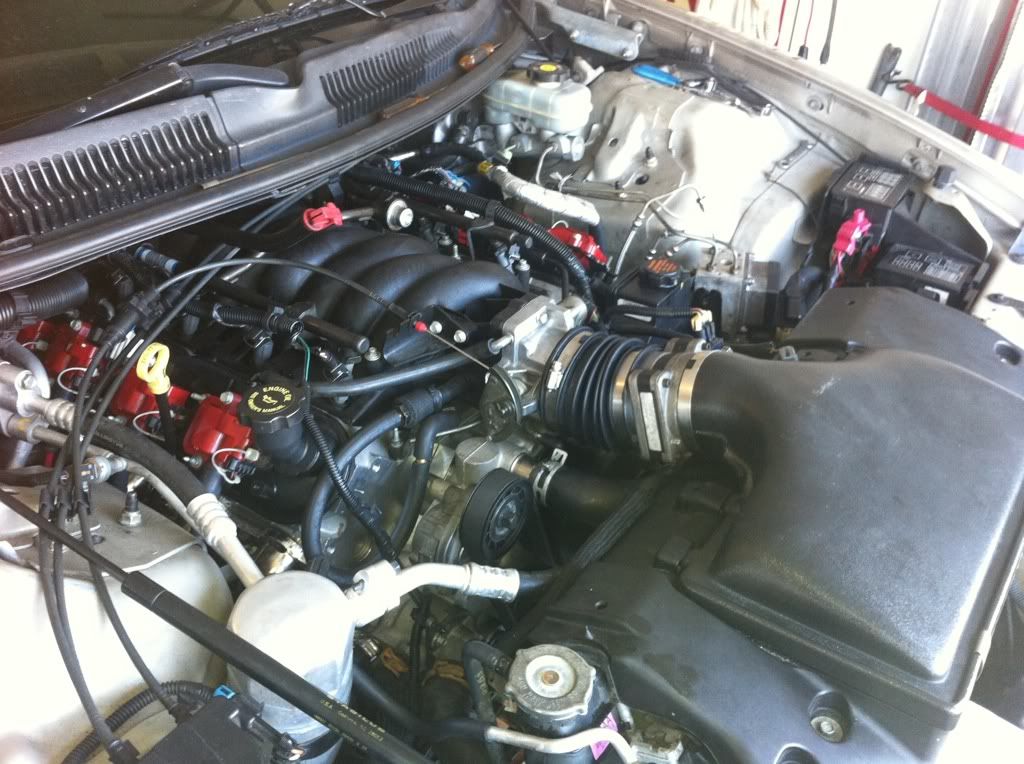

    Well guys I've been posting here and there that I got a practically new ls6 short block from a friend of mine cheap and that I was tracking down a set of heads to complete it... Well I finally got all the pieces together and heres the progress so far on the swap.
    NEW LS6
    Basically now all I have left to do is put the new motor onto the k member and reattach the tranny and swap her back in. Overall its went pretty smooth so far with just a few quirks here and there. I did use some vht wrinkle paint on the valve covers just for a little bit of a different look also. Tune is coming soon I'm sending out my pcm to frost tomorrow to get tuned.. I'm debating on descreening the maf and having him tune for it any thoughts? BTW car is an auto

    Do not descreen your maf!

    It fits fine, its just like an ls1 so everything is just plug and play.
    Why not? Frost recommended doing it and if its because of a valid tuning or running issue let me know but if its because debris may get in there I dont consider that a huge reason because all new gm mafs do not have screens and nothing that big should be going past the air filter anyway.

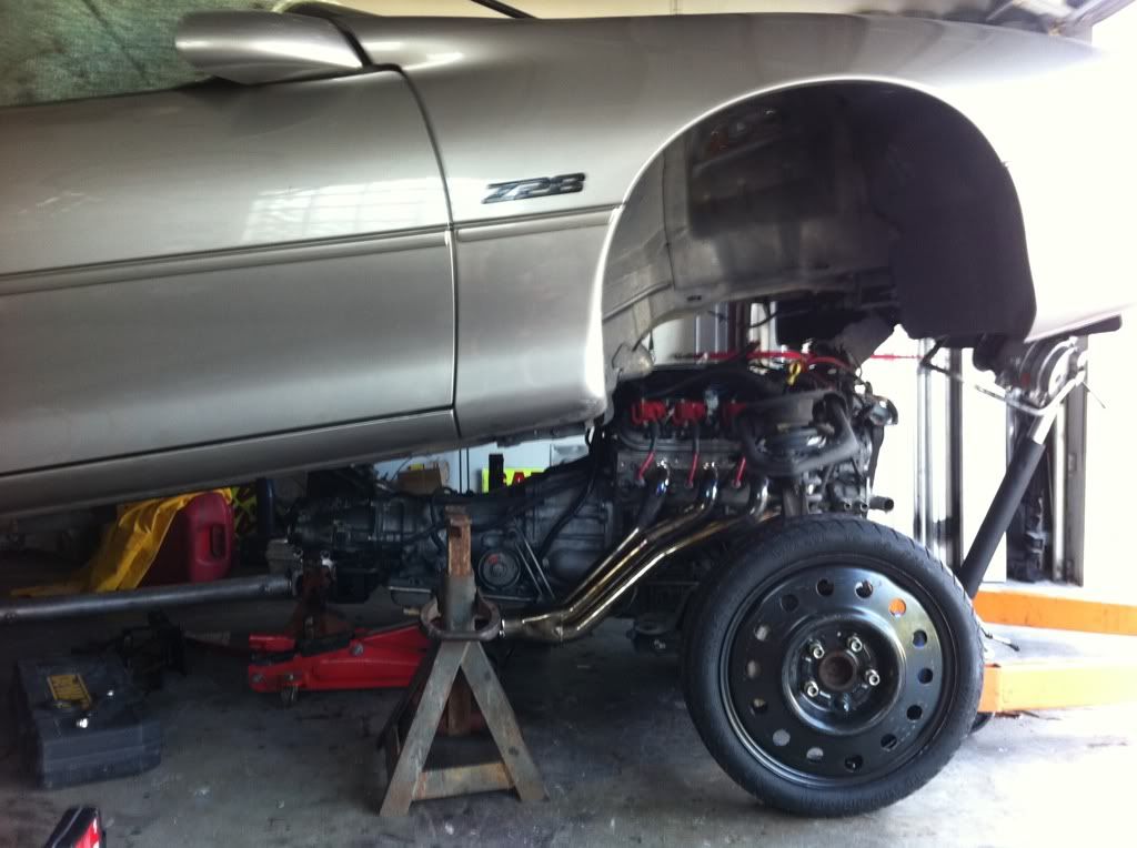

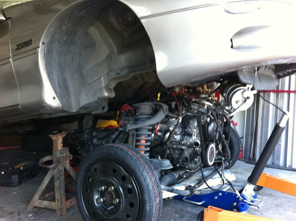

    are you holding the car up with the cherry picker?

    Quote Originally Posted by jiveass View Post
    In that pic yes I was then I got some big jackstands and set the car on them then pulled the motor out from underneath.

    looks good bro i just did the ls6 swap in my 01 ws6 last september. i descreened my maf and had it tuend by frost and have not had any real issues. car is a beast after about four grand. cant wait to get her up tothe track to see what it will do. good luck with yours.

    Frost told me to descreen the maf. Its been like that for almost 4 months. no problems

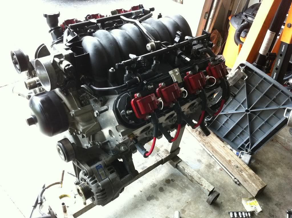

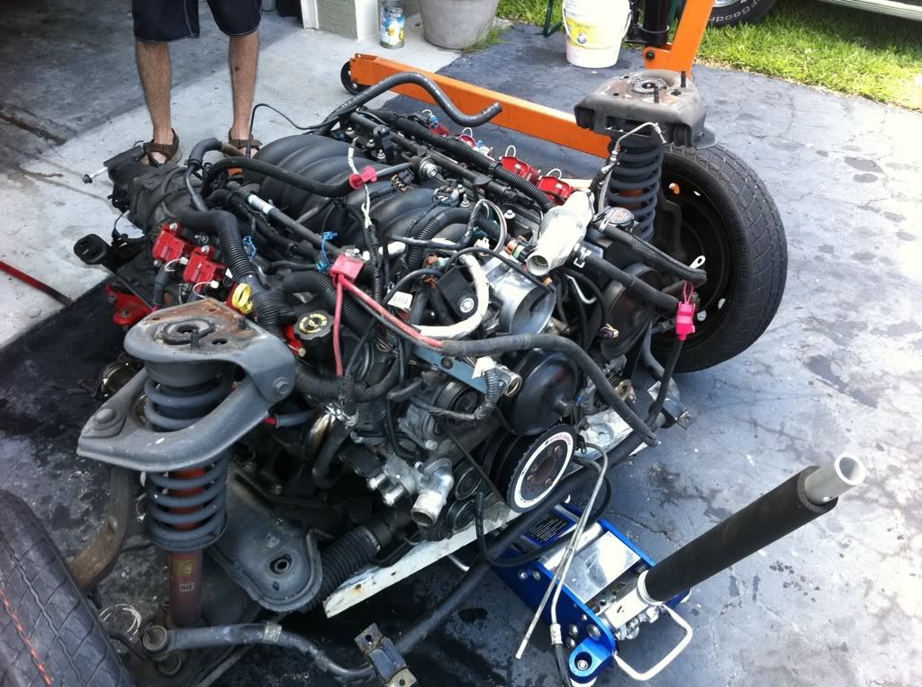

    Engine is finally in my pcm is still in the mail from frost so I wont be able to drive it until tomorrow. Hopefully today I will get to use tatertot's pcm today (if he ever shows up to my house ) even though his an m6, atleast be able to hear it run just wont be able to drive it. Excuse the pcv setup gm wants 65 bucks for the little hose that goes there and I havent been able to find a good solution yet it is the pre 04 style valley cover so it still uses an external pcv valve

    The ls6 valley cover had 2 designs the first was was 01-03 and it used an external valve like mine has. If your motor was built in 04-present you have the new one with an internal pcv
