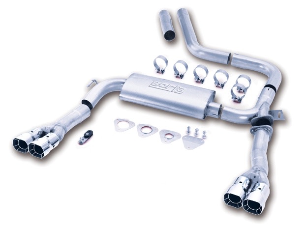

    I have a 02 WS6 with a Borla catback system. I like the sound of it, but i want it much louder. To be completely honest, the person before me (I just bought this thing less than a year ago) put on the Borla, so i have no idea what size restrictor plate is on the passenger side. I hear sound and feel air coming out of it though, so i know it isn't closed.
    Does anybody know the difference of the volume for a open passenger side plate vs a medium to small sized one?

    Why not unbolt the flange and see for yourself? If there's a plate in there remove it.

    Ohh and I also have the Borla. There is a slight difference between open and the smaller plates but closing it up altogether makes the biggest difference (in the opposite way). Imo if you really want it louder than close it up altogether and put a cutout in the I pipe, this is what I run now. Much louder with an open cutout in front of the axle under the car. I have a DMH electric valve on it and can open/close it from inside the car. Ohh and welcome.

    The Borla Adjustable cat back system has a single 3 inch pipe coming from the y-pipe. That pipe goes up over the axle and then tees off so you can have dual outlets. One pipe exit each on the drivers and passenger side.
    The drivers exit goes through a muffler. The passenger side is straight trough (no muffler). There's a joint there that you can install a resistor plate to adjust how much exhaust and sound comes out the passenger side. If you completely block it off, all the exhaust goes through the muffler and out the driver's side exit. There's also a plate with like a 1 inch hole and a 2 inch hole and there's the option to not run a plate at all (wide open noise and flow.)
