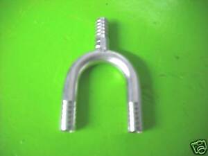

    THis is a great thread with great suggestions. I used the ideas and I think did one better. The "Y" at the back can be replaced with an item I found. It is light, and stainless steel and cheap! It is Stainless Steel Fitting Barb U-Bend 3/8" Coke part number 21136 It is for a coke soda fountain and I found it on ebay. 4 of them cost $6.00 It is easy to connect with a couple of pieces of 3/8 tranny hose. Fits great. Trying to figure out how to post a picture here. I will when I figure it out.

    Must be this?

    Yes ! That is it. I just cut back the platic tubes a little bit and coupled it with 3/8 tranny hose. The part is only 1 1/2 " wide and 3 in. long. You can also cut back the barbs some to make it shorter and yet have plenty to put the hose on with a clamp. Thanks for posting the pic!!.
    Joe
