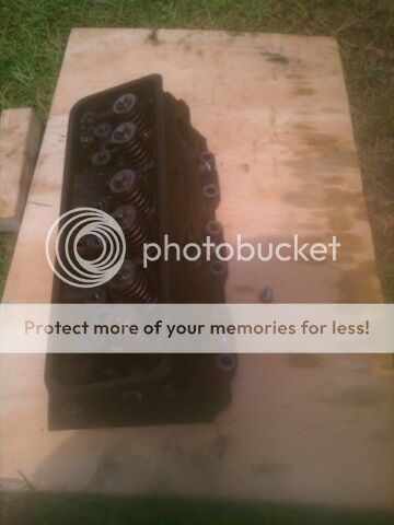

    Took this last night, after I scraped the sludge out to find the head bolts

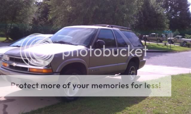

    Here his first vehicle. If the block dies I plan on finding a GEN III block and updating it. Screw having a 4.3.

    Nice, should be a great little truck. Someone I know swapped in a 5.3 and it was a pretty straight forward install. Would be a great future project as well.

    Ah yes, the dreaded Pennzoil peanut butter...
