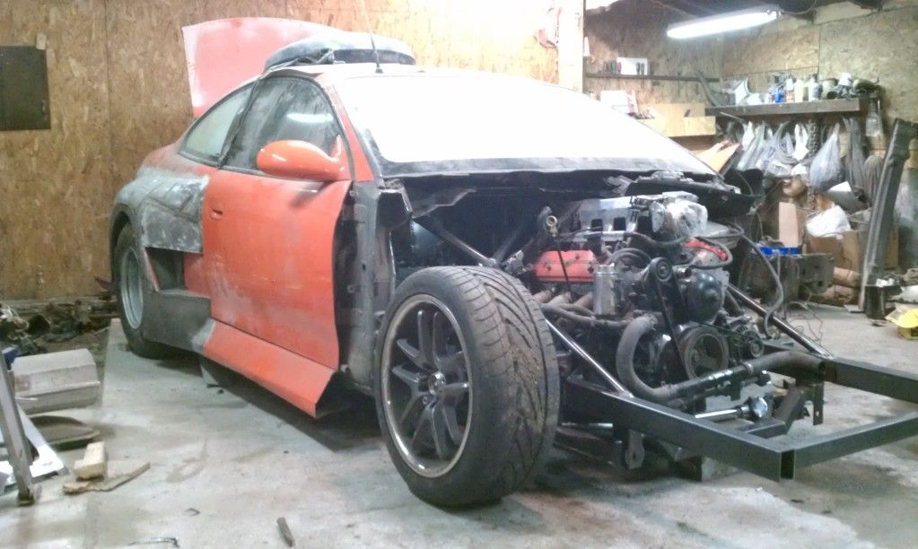

I've already done a lot of nodding and fabrication from behind the firewall back to the rear bumper with a full 4 link backhalf and Ford 9" solid axle, cut the whole floor out from the rear bumper upto the firewall and ran a full frame to just under the dash, NHRA legal 10point roll cage, tubs, and new lighter stronger floor.

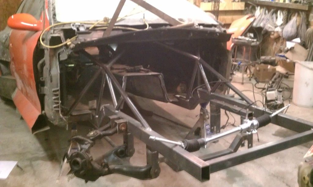

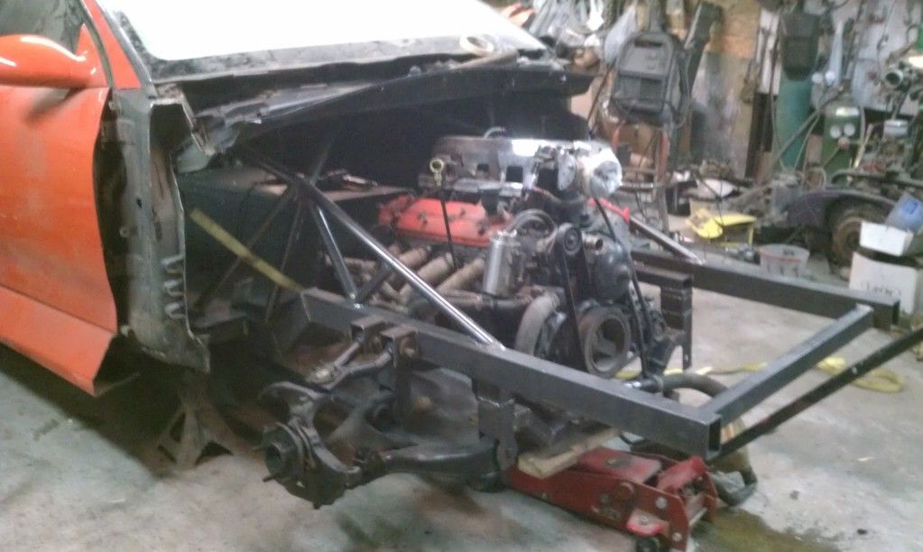

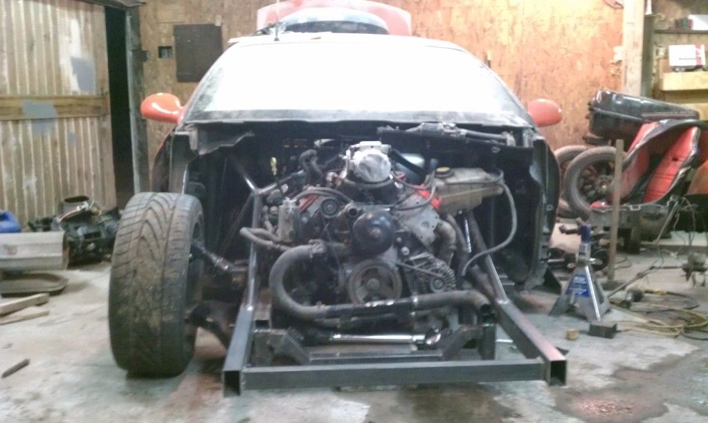

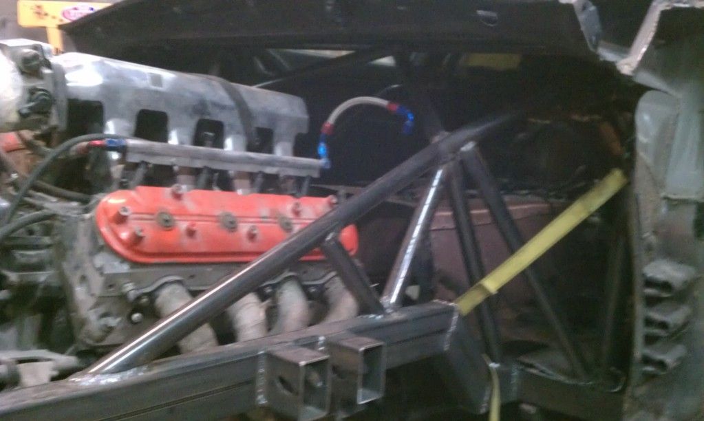

Here is my next thought......I've found most of the weight in our card is in the floor structureand bulk heads....its almost likethey built thecarto bea convertible...so since I want to lose more weight out of the car, and hope to improve handling at the same time I was thinking of going with a front tube chassis and 4x4 S-10 front control arms, spindles, hubs AND torsion bars... This will drop a lot of weight, keep a low profile chassis configuration, allow all cheaper aftermarket parts (like tubular a arms) and I can tie into the dash bulkhead and the 10 point cage to add strength to the whole chassis ( think dun buggy or race car tube chassis)
Any thoughts or ideas on this? I already have the S-10 chassis sitting outside the garsge ready to be cut up, measured and even though I could change it if I wanted to the wheel track is almost right already +-1/2" or so
