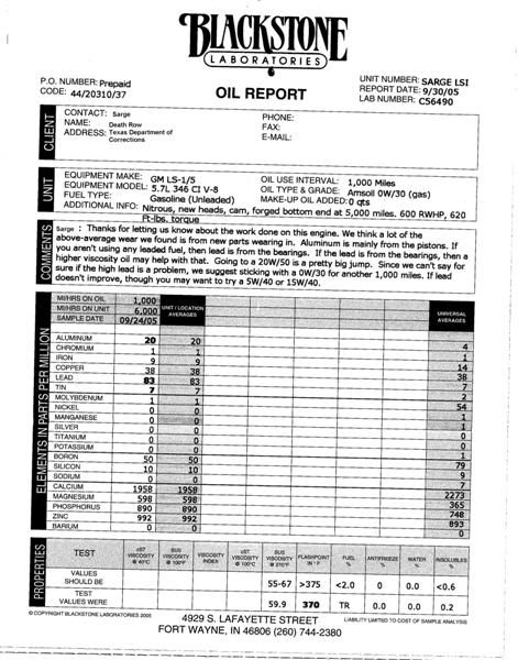

    Blackstone Labs UOA 600HP LS1 Amsoil 0-30
    New Heads/Cam/Pistons/Rods 1000 miles ago. Running Nitrous/forged bottom end. Brutal 1000 miles for sure. I ask the question on the viscosity to solicit an opinion of the lab tech .... I am very impressed with the wear numbers considering all the new parts and the conditions. I solicit your opinions/observations.....
