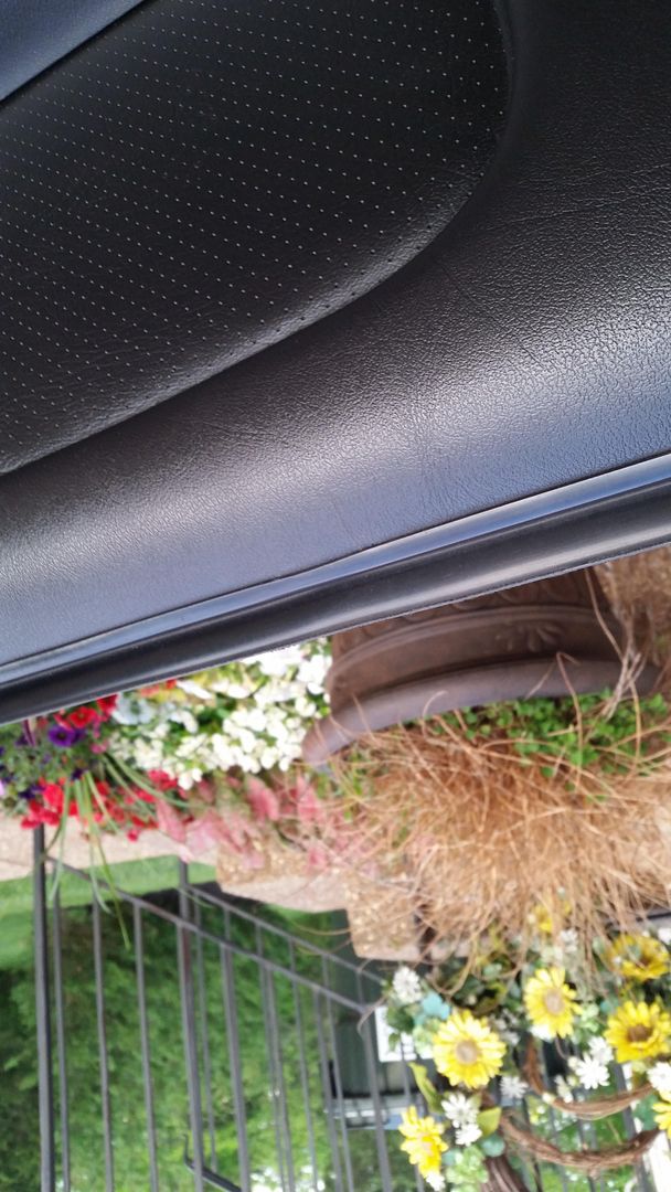

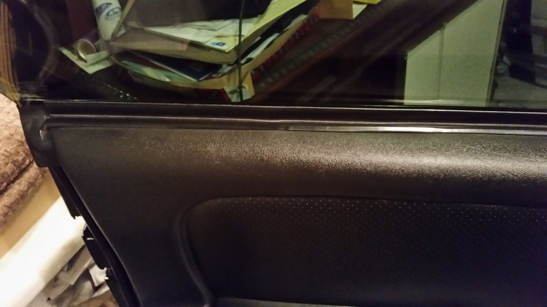

    I fixed mine pretty easily...pulled the panels off, took the factory staples out, zip tied the crack together on the inside of the panel, scuffed up the back side of the crack, put some Jb weld plastic adhesive on the back of it, replaced the staples with paperclips and problem solved. Super easy and can't tell that a crack was ever there.
    Before:
    After:
    I took this picture at this angle on purpose because you can barely see the edge of the crack but if you dont know what to look for you'll never know it was there.

    Nice job, Patrick. You can barely see the cracks, but only if you know what to look for.

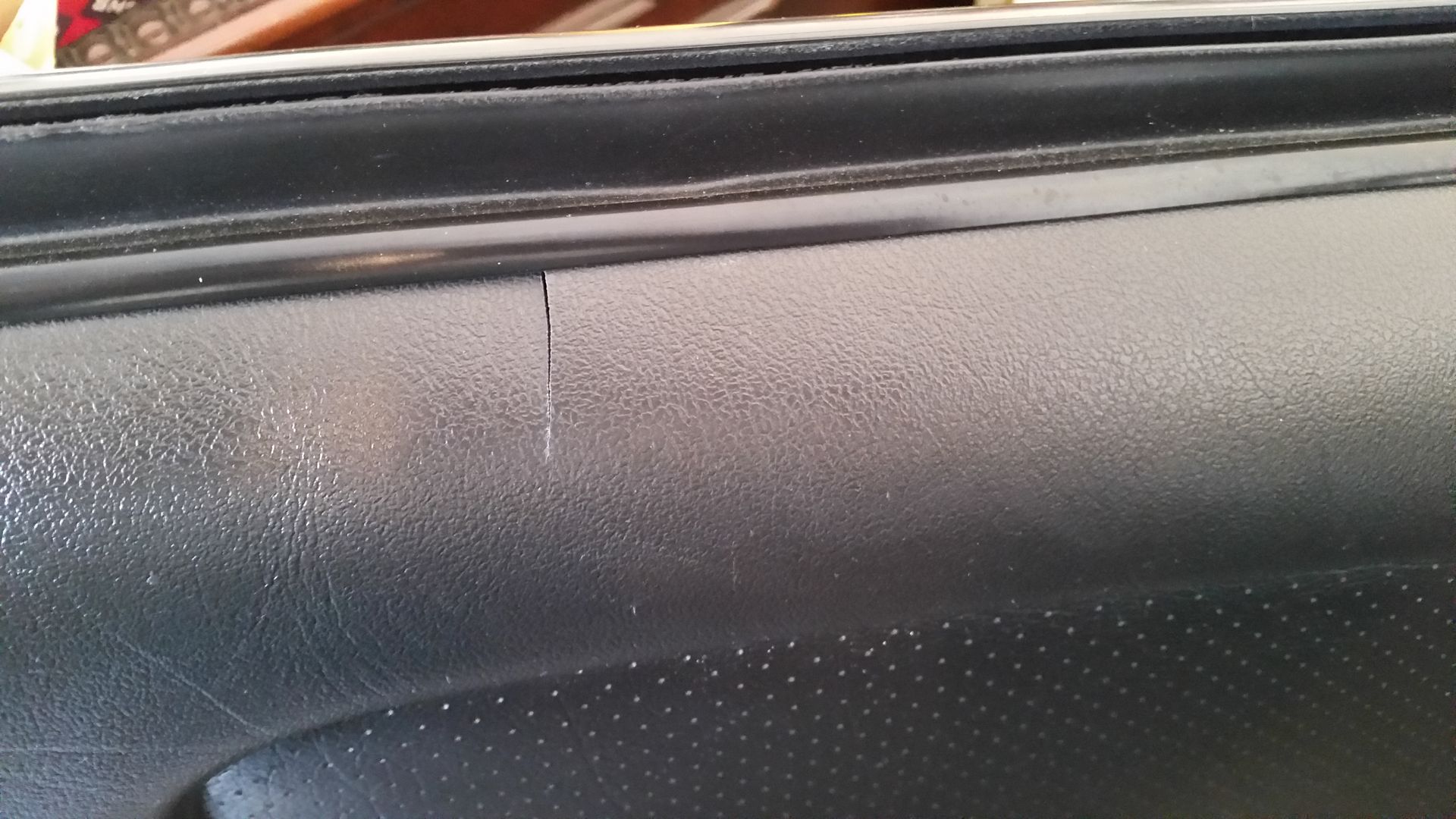

    Well, I braved my cold garage and finally got around to swapping out my old door panels for my new-er and now improved door panels. When I bought them at GM Carlise, I thought they were both uncracked but once I got the weather strips off, I discovered the the passenger side was JUST beginning to crack. So I treated them both like they ARE cracked. I had some metal mesh that i cut to fit about 4" wide and bent to fit the curve ( much sturdier than screen material ). Then I spread a nice thick coat of Permatex black silicone adhesive sealant ( item # 81173) a little bigger than the patch and mashed the mesh down into it and covered that with another coat. I gave that a good couple/ three days to dry in a warm house. I reattached the weather strip with the small screws & nuts. I tried some wire but it just wasn't cutting it for me. Anyway,, it looks so good now - like it did when it was new !! My interior is nearly perfect and those cracked panels were driving me nuts. If it cracks again I will loose my mind. Now, I'm going to fix my old ones the same way ..just because ! Those cracks were really wide and all the way down. I'll let you all know how that turns out. Maybe I'll attempt some pictures -- I haven't figured that out yet.
