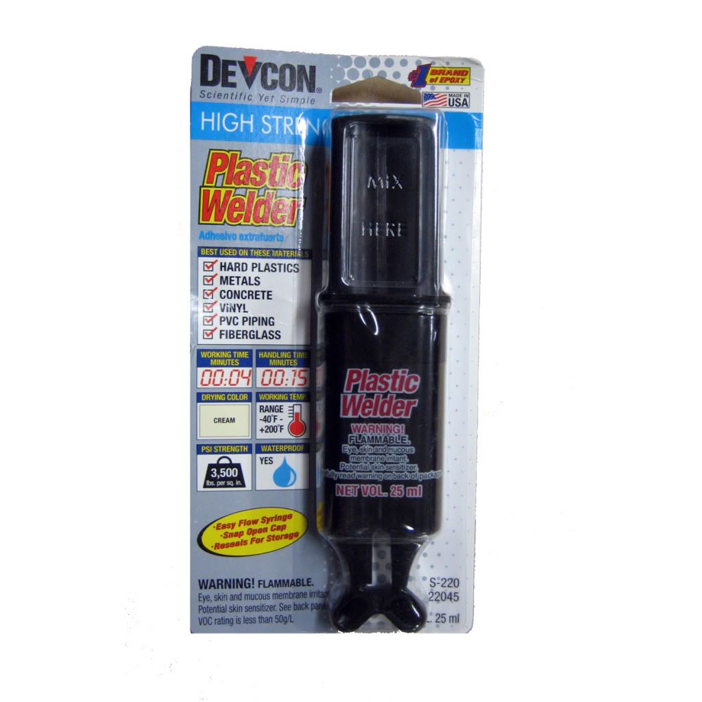

    HI Has anyone ever had the panels plastic welded?

    Quote Originally Posted by chevyhump View Post
    Do you mean a glue product the refers to itself as "plastic welding"?
  10. #110
    Member nichoLaS1's Avatar
    Jul 2010
    Charlotte
    330
    Sunset Orange
    '01 SOM ws6
    this?
    If that is what you are referring to then, yes thats exactly what I used, and it worked great; havent had any problems. Just make sure you mix it properly and allow for it to properly cure.

    This is the epoxy I used.
