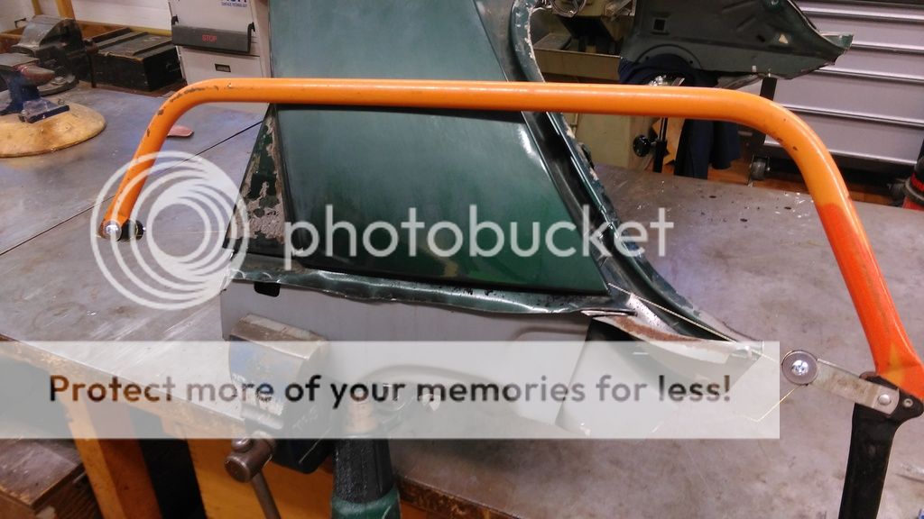

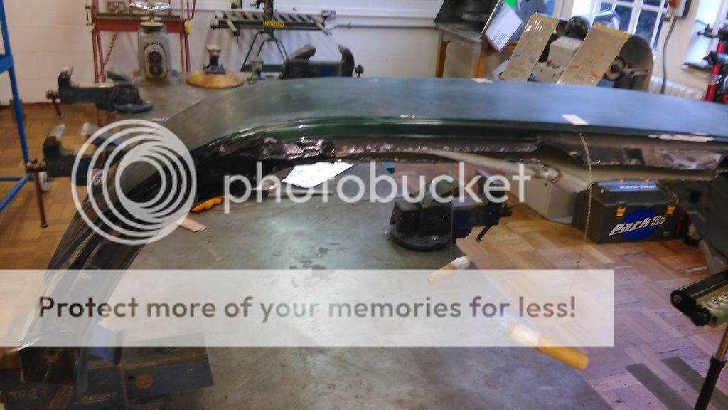

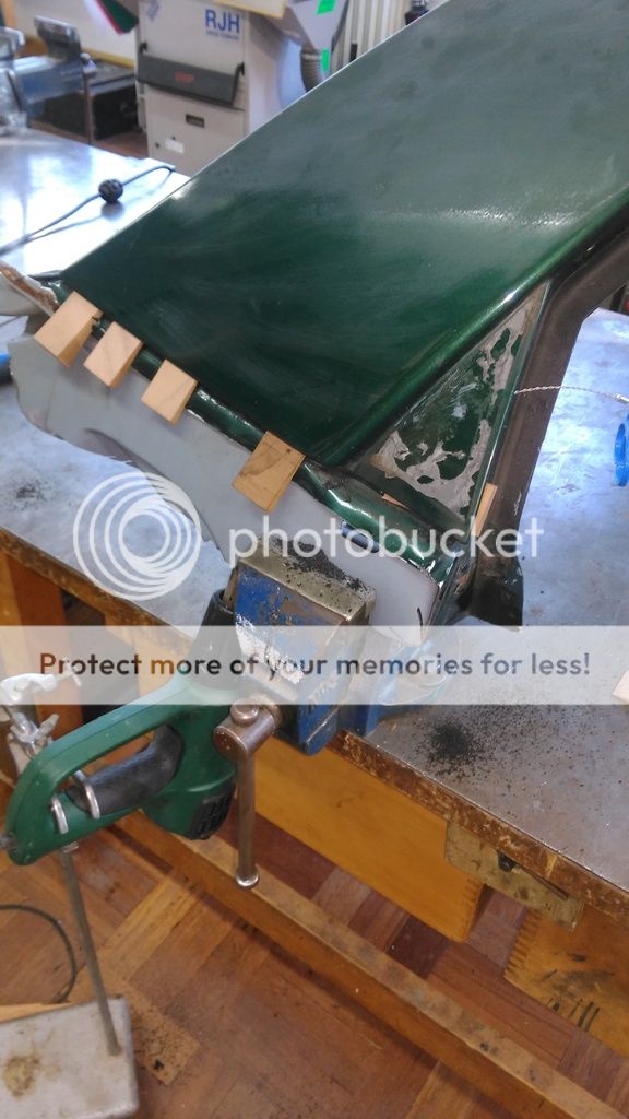

    Update on the sail panel.
    Waited until the end of our school term so i can devote more time to a session!
    This pic shows an epic fail...
    This pic shows a sh*tload of wedges trying to help open things up for the wire.... Not really helping!
    This is after i FINALLY get past the horizontal swathe of glue and start heading up through the two thinner vertical lines of glue. Hell of a lot easier but still a chore!!
    The outdoor commando wire saw has hit the spot though as it actually saws and removes a kerf with debris as opposed to the glazing wires which are smooth and do SQUAT!!!!
    The dowel handle wire you can see is a length of slightly heavier outdoor wire saw, wire from a 10 meter version of the saw so i can clip it into lots of fresh saws for best cutting
    So... slowly getting there and i still maintain that the people who reckon this can be done in two hours are crackheads... lying crackheads!!
    Strangely there does not seem to be many, if any, members here which have done this? They all seem to be over on tech??

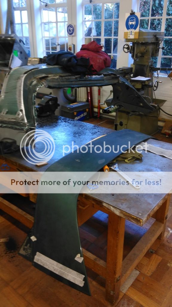

    Well....
    Waddaya know? Santa has brought me an early Xmas present!!
    Led me a merry dance and i never want to do another... EVER. Allen, how did you get your panel off? I am intrigued to hear your time with the sail panel??!!
    There area couple of areas where the wire saw rubbed a bit off and one spot will need a bit of glass laid into the back to give some thickness back but no big deal!!

    Quote Originally Posted by Whamhammer View Post
    I thought that I saw fiberglass and a carbon fiber aftermarket peice out there, are they that expensive, bad, or do you guys like punishing yourselves that much?
    Well.... You are right in that 6LE do sell them, or did but they are an expensive item especially in carbon
    but the shipping to get it to me would be hideous in that it would have to be packaged very stoutly
    to stop it folding in half in transit!! Just not do-able.
    Although tedious and and a chore it was "simple" enough. Once prepped and painted i will bond it on after stripping
    my existing one off with the acne and it will be good to go!
    The work does not worry me in that i am a vehicle body builder by trade and it is all pretty simple by and large.
