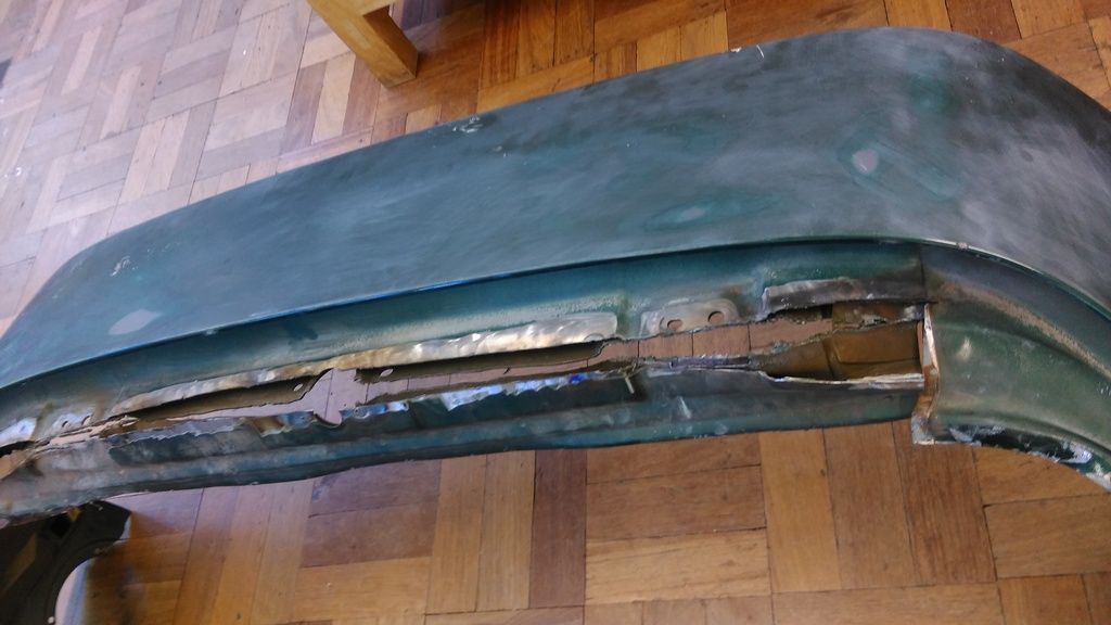

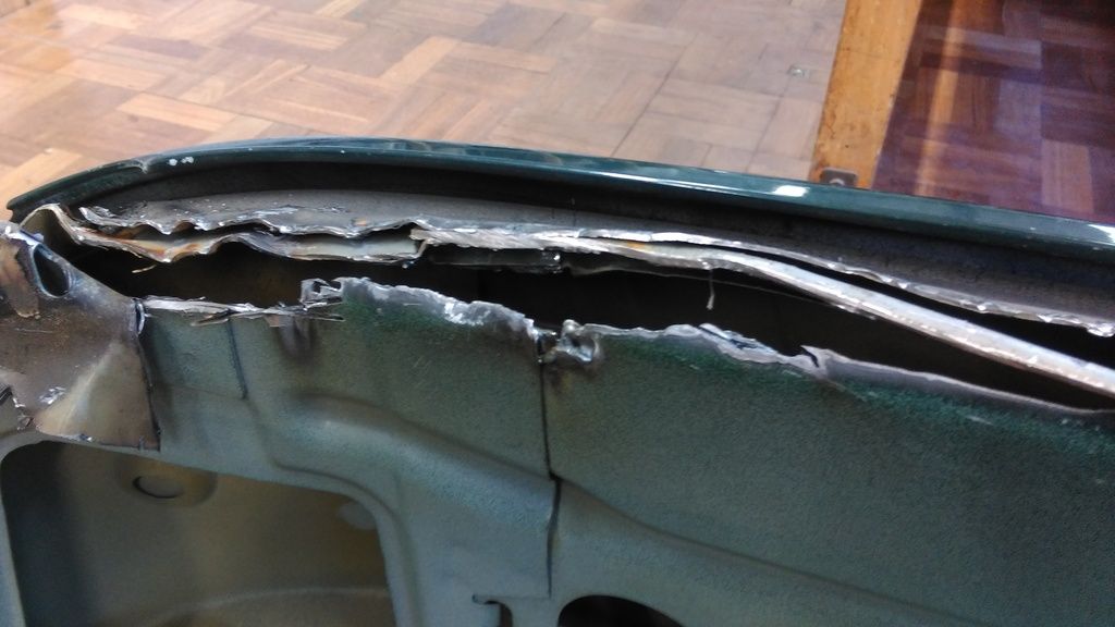

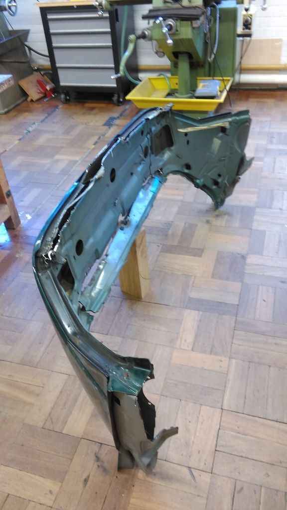

Been cracking on with the sail panel and although the pictures are not very pretty,
they show where you need to get busy with the cutting and folding.
I used both plasma cutter and angle grinder with a cut off wheel... Oh.. and a big hammer
and chisel and a big pair of vise grips and a hacksaw and probably something else too!!
Key is to make sure the sawing of the wire does not start chewing at the fiberglass on the
turned down edges of the sail panel which is why all the bending and stuff is needed but you knew that!!??
I made a wire saw out of 1.6mm square section windshield removal wire and broom handle
pieces for the handles.
Watch this space. I will wrestle it onto it's back tomorrow on a great big lump of foam and go
for it.
Please let me know if the pics are not showing?? I still stick them in photobucket and i believe if you don't
use that little add on for your browser they don't show???Last edited by speedyWS6; 11-04-2018 at 08:19 AM.

Hmmm....
Went at it for about half an hour with a bud holding the roof down
on the bench and really got nowhere fast!!!
The square wire tries to cut it like a knife and so removes little waste.
The fact it is trying to cut it like a knife really makes it hard work so
i have ordered a roll of the braided wire, which the guy selling it says
it is really aggressive and cuts like a saw... which is what i am after so
we are on hold until i get the new wire!!!
On a brighter note... the triangles came of with a heat gun and a pry with
a wide scraper but contrary to what i have read, you have to go at them
from the side whilst protecting the panel with a few strips of masking tape.

People who claim to remove the sail panel from the steel roof section in a couple of hours are either lying... on drugs....
..... or maybe a magician??!!
I have been sawing away with two types of windshield wire. Both the square stainless and also the
braided stainless. I have painful aches and have moved up from the bottom about two inches!!
Ok... I think i need the heat gun big time which i have not really bothered with and i am going to
try and turn a big bow saw into a wire saw rather than the two bits of broom handle!!
Ever wish you never started something?

I have made my windshield wire bowsaw and will have a go tomorrow.
WITH a heat gun on the go.
