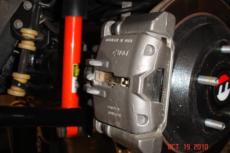

  15. #55
    22,146
    Quote Originally Posted by BashamWS6 View Post
    is there a write up or pics for this griding process.. ive searched but all i find are threads with people talking about it
    I installed 15" Bogart D10's on our car for the track. Although they cleared the stock calipers, I did grind the ribs down a bit for some added insurance:
  16. #56
    Aug 2010
    Oklahoma City, Oklahoma
    1,807
    sebring silver
    Y2K SS CAMARO
    28x10.5 is what i ran on the ss and had to grind then grind and keep on grinding to get the needed clearance lol
