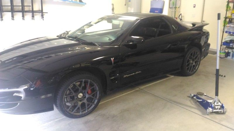

    Got some new wheels and tires finally, next up is the front and rear coilover install but I got to build up the initiative to start that task lol.
