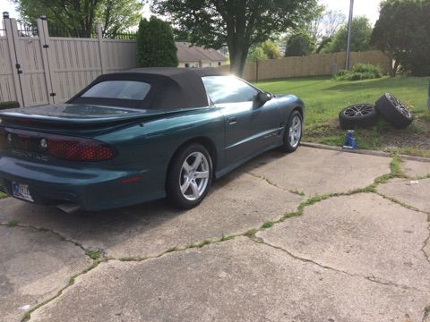

    New DRL/Turn bulbs and fog light bulbs plus tossed on these 17s from a bmw to try something different.
    Nice, are they 17x9's? How much do they weigh?

    17x8 n 23 lbs I think

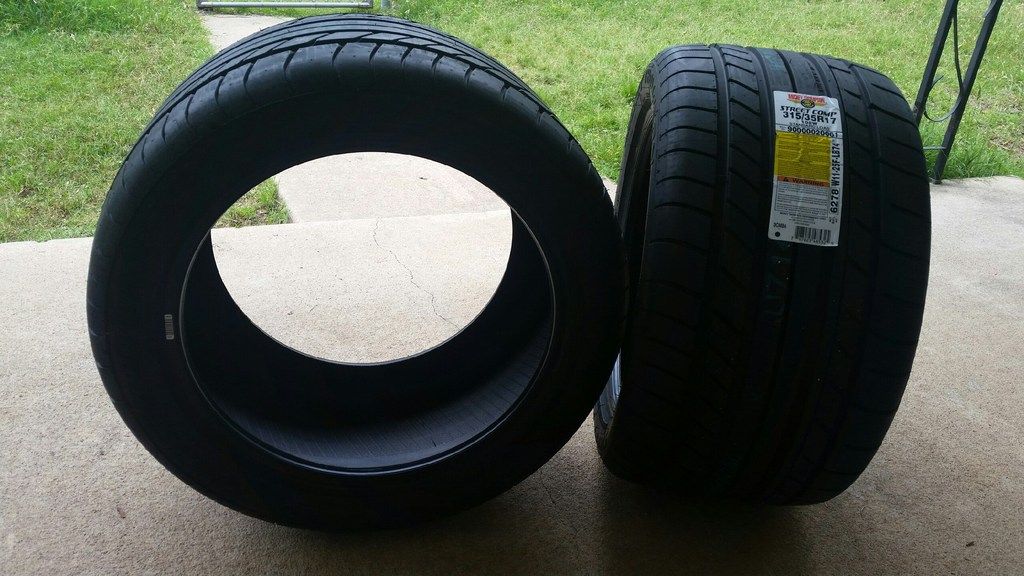

    Ordered a set of Mickey Thompson Street Comps today for the T/A. Had to order from two separate sites to get what we wanted, Summit and Jeg's had good prices but were backordered on the 315's (with an estimated delivery of September, whaaaaaat), so I ordered the fronts through Summit and found AmericanMuscle had the 315s in stock. Overall the prices were pretty good, about $200 cheaper total than the next tires up I could get in a full staggered set. She drives 5-10 miles a day on average, so they should last a little while.

    Back tires came in for the T/A yesterday.
    Fronts should arrive today.
