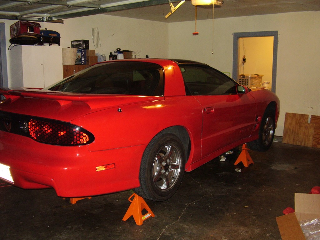

    Got the Bird out of the garage and decided to change oil, she looks like she wants to take off..............
    Sometimes they take full flight.
    one step forward three steps back....
    turning into my subdivision my drivers front wheel came off....3 studs snapped and I can't find any lugs....
    That happened to me last year on my way to work. About a quarter mile from my office I hear a loud clunk and my rear driver side drops down. I manage to get into the center lane of a divided highway and get out to find all 5 studs are snapped off. Luckily I wasn't going fast and the rotor dropped down and was riding on the rim. No serious damage to the wheel but the scars on it still make me mad.
    It’s a Wheel of Fortune I Didn’t Die | 2000 Trans Am Blog

    Oil pan, wheel & exhaust all are good. Only victims were the lug studs, rotor, oil filter & center cap for the wheel. Thank God I quickly shut the engine off. Only loss about 4 quarts of oil. Guess she wanted an oil change...
    I went ahead and replace the hub figured with 170k miles on it might as well, plus new studs already installed. Got new lugs as well and made sure every damn one of them were tight. Has to get the wheel re-balanced because the weight came off.
