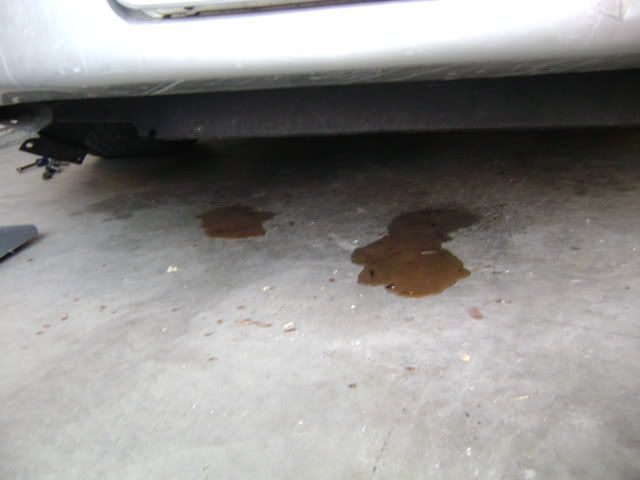

    Found it. Cracked radiator.

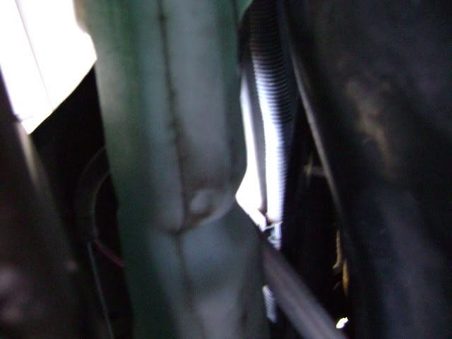

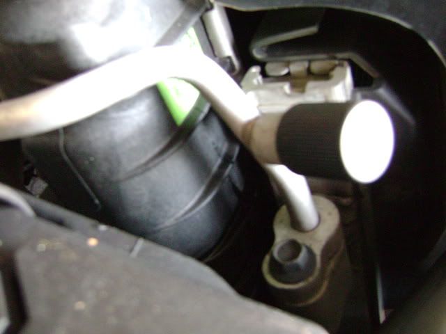

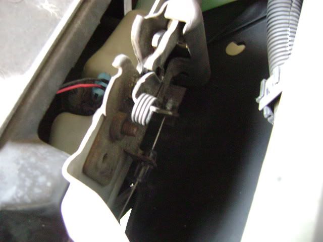

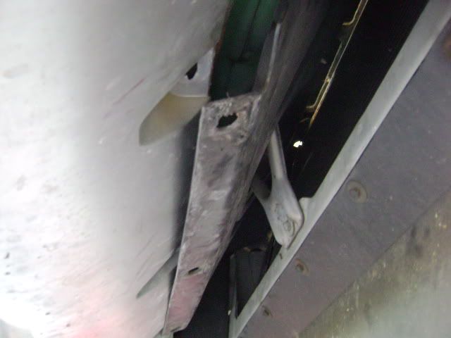

    here are some pics:
    hood open:
    hood latch release - top view:
    front bumper and black should retainer clips need to be pulled to gain access. also remove the 10mm bolts that
    hold the front inner splash guards and the first (2) that attach it to the air dam as well
    this is where you will need to blindly feel around for the latch release (or in my case the
    hood release cable), to then release it
    cracked radiator, which leaks, runs down the core support and gives me the (2) puddles you see.
    happy its not the water pump/hoses, all that stuff was bone dry baby!!!

    I can smell the coolant on the passenger side but after 20 minutes of running in 100+ dgree weather in the garage, no leaks. Nothing. Before you could see an ever so small puddle...
    Coolant leaks at hose junctions and such are more prevalent when things are cold versus heated up. Just about every leak I have ever had on a car would weep when cold and then stop when hot -- even with the added pressure in the cooling system. Go figure. I see that you found your leak after I jumped to the next page.

    Got the bastard!!!
    Lucked out as the cable was not broke right at the releas latch. Loosened the plastic underneath and with the general idea of where it was at, I had to blindly feel around. Found the cable, pulled it out and then pulled on it. No binding at the release point.
    Will post pics later. Now it's time to locate the coolant leak.
    You did something of what I said in post 9
    That should release some of the pressure on the latch and make it easier to release.
    Since you are going to have to replace the whole cable; If you are able, look for the cable and pull out the excess till you either reach the broke end or have enough to peel back the sheathing and then take vice grips and pull on cable. That should release the latch. This method has worked for me twice on an old truck that I used to have.

    yeah, couldn't really see, but knew i had to 'head towards the light' while feeling around. the cable was long enough to pull out and then pulled on it by hand. got the vice grips out for nothing...
