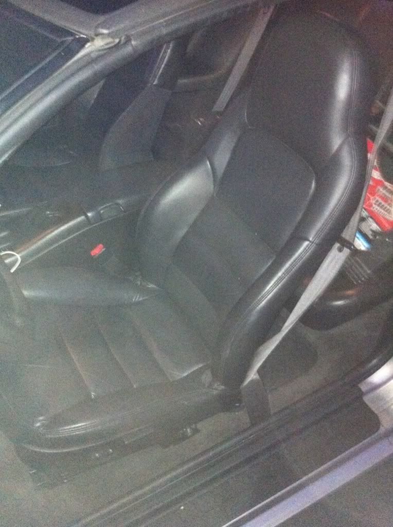

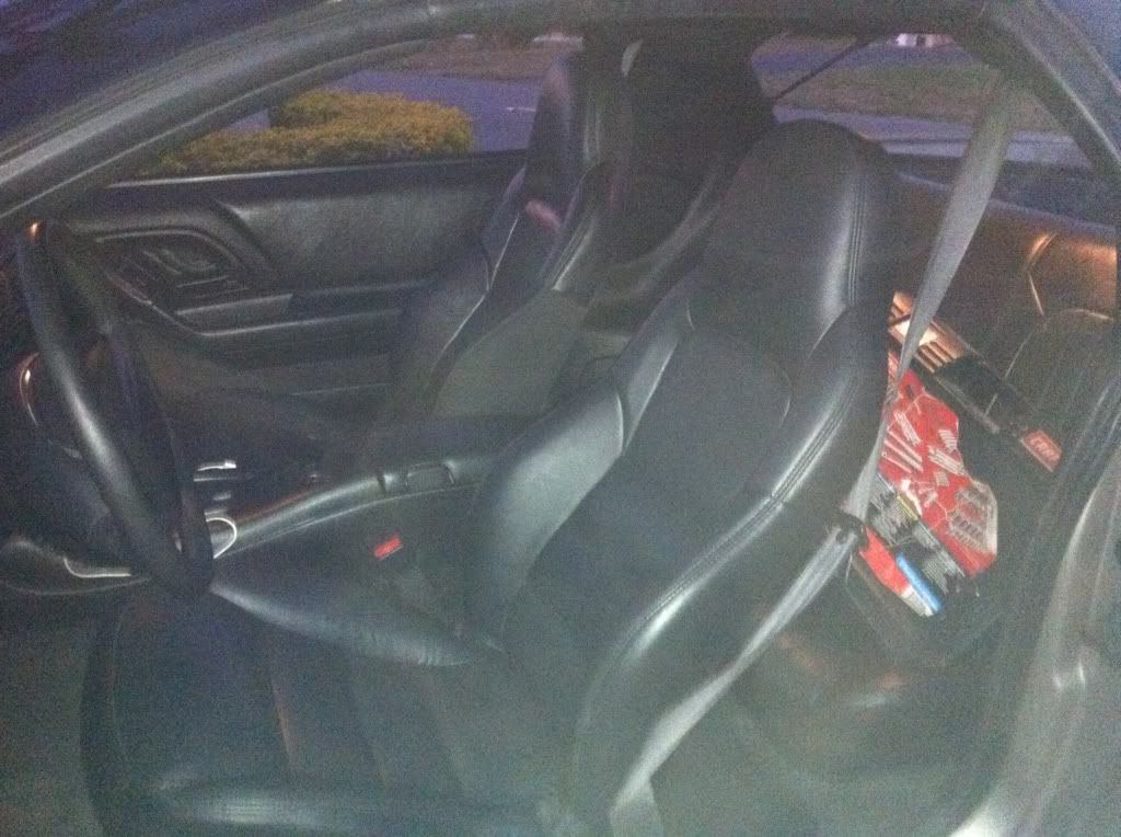

    2002 Camaro Z/28 Pewter
    Here are some teasers until I can get some better ones...
    Ya these are from iPhone I'll get better ones tomorrow and post of pics of the fabrication

    2000 Pontiac Trans Am WS6
    look like they belong in there looks awesome

    what are you going to do about the seatbelts? it'll wrap around your face if it doesn't have the guides....
    the belts aren't too bad because the seats sit a little higher than the stock Ones do but eventually I'll prolly get the leather sew on ones from 6liter eater seeing as there really isn't a place to mount the old knes
