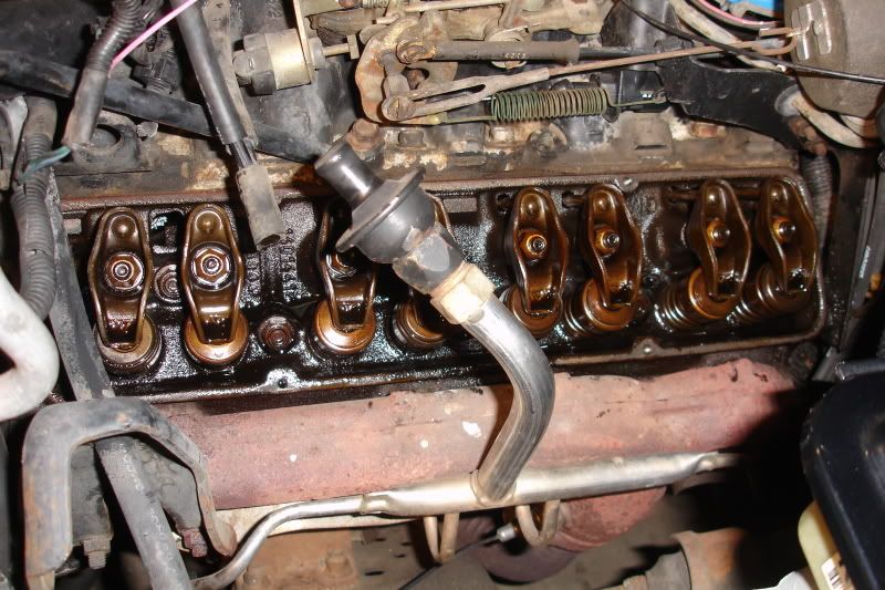

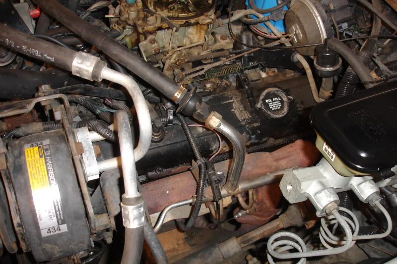

    Before putting the cover back on the HVAC box and reconnecting the heater hoses, I started on replacing the valve cover gaskets this evening. Somewhere under all this spaghetti there actually is a valve cover:
    It took quite a bit of time, and I think I snapped every plastic vacuum line I touched, but it finally came off. The plastic stuff is just a bit "crispy" from both age and exposure to underhood heat. I bought a roll of tubing from the local Autozone to replace everything I broke. Anyone know if the tubing just presses into the rubber elbows, or is it glued or chemically bonded?

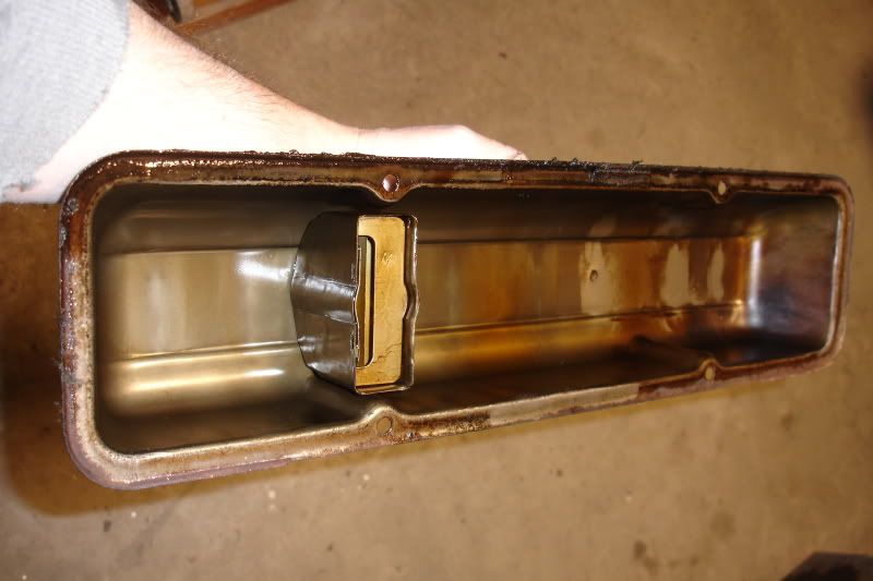

    The moment of truth -- after pulling the valve cover I flipped it over to see how crudded up the engine is. Not bad at all for a 25 year old car:

    Cover looks nice and clean inside.
    The plastic lines just push into the rubber elbows. Piece of cake.

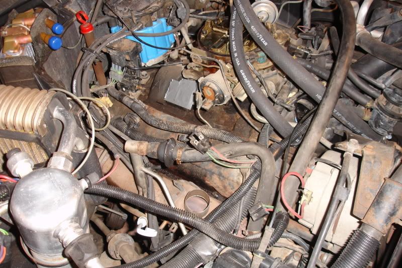

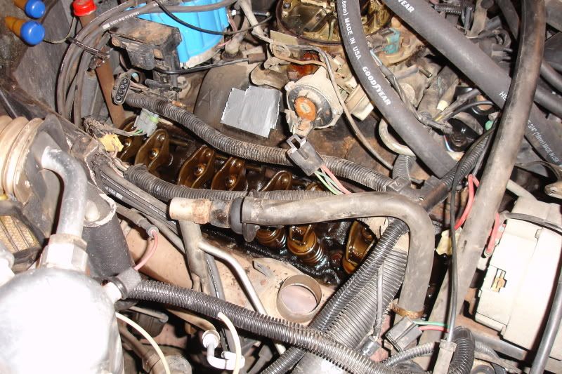

    Moved on to the driver side this evening. Much more room to work than on the passenger side. I had to remove the vacuum feed to the brake booster and unbolt the A/C compressor to extract the cover. I'll replace a few more vacuum lines while I am at it and do a little clean up.

    How bad was the air injection tubing in the way? I remember some cars I had to "massage" that spider out of the way with a prybar to get the covers off since usually they don't come out of the manifold in one piece.
  13. #193
    22,146
    I had to lightly pull the passenger side assembly away from the valve cover and zip tie it to the A/C dryer. The driver side, I moved back by hand just a touch as I lifted the valve cover off the head.
