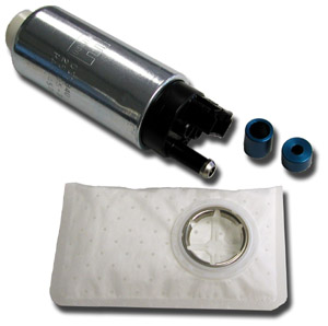

    Well I would start off by ordering a fuel pump from LPE.
    http://www.lingenfelter.com/store/l710660504.html
    You need those little billet nipples for it to work properly.
    Then I would do the drill mod to your bucket.
    While doing that you need to replace the feed line that goes from the tank to the fuel line running down the frame. As it is kinked from the factory and causes a restriction. They use a hard type plastic that once you kink it remembers............
