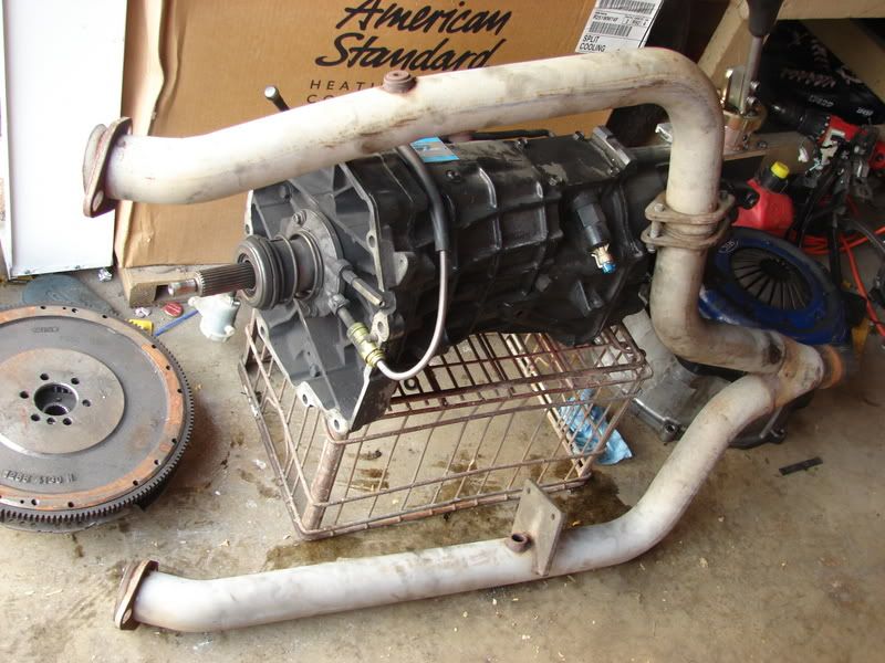

    how do these look? Is the rust a really bad thing?
    Member MISFIT's Avatar
    Aug 2006
    nowhere
    512
    i would get them refinished.
