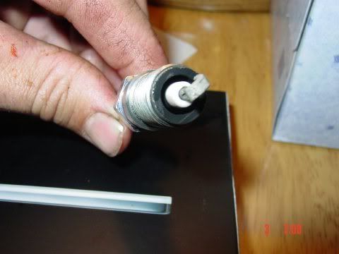

    Hi I just installed the sts turbo system. I am only running 5 psi of boost because my compression is 11:1. I have a lingenfelter 219/219 560 lift 112 cam. bbk 52mm throttle body, advanced induction lt1 heads, hooker long tube headers, 42 lbs injectors, methenol injection, tr6 plugs tune by pcm for less. car was dyno 360 rwh before turbo install. o.k first question Iam getting lots of water out the exhaust, is this normal ? second problem I drove the car a few times but I doesnt seem to have any more power, It wont even brake the tires loose in second gear,thats with 410 gears!
    I just pulled the plugs and there white. the only thing that I have not done yet is upgrade the fuel pump. I thought with only 5 psi of boost the stock pump would be o.k. would this cause the poor power ? Is there anything else that may be the problem ? I will order a new fuel pump tomarrow, other problem is it will be a problem to drop the tank to install, because turbo, exhaust are welded. can I cut a hatch way above the pump to replace it ? If any one has done this, is there any pictures. thanks..

    It sure does sound like you are running lean (white plugs). I'm amazed they didn't suggest putting an inline fuel pump after your stock pump for the added ponies, or at least a bigger pump to replace the stock pump. If you order a new fuel pump, I'd advise against getting the same size stock pump.
    What is your fuel pressure running at WOT? Do you have a boost gauge? Are you achieving the full 5 psi that you are looking for? Water coming out of the exhaust is not normal. Is your coolant level in your radiator dropping? Is it possible that you have a blown head gasket?
    I hope it works out for you! Let us know!

    Well I just got back from the dyno ! the problem is not what I thought.
    the car is running extremly rich, as soon as you go w.o.t It falls on its face.
    Air/fuel is 10.0 at all rpms. thats as rich as the dyno will read. so it might be around 8.0/9.0 ? only made 182 hp @3400. on the second run I unhooked the methanol injection. air/fuel started @ 10.7 then right to 10.0 but made more power 295hp. this really sucks ! I started @ 360 hp But at least I know the problem. car only makes 4.5 psi of boost. I wish I could have it dyno tuned But there is no place in n.y that I can find that has the software for LT1 to do it!
    So I will be sending the computer back to pcm for less tomarrow. I wonder how close my timing is ??

    So....your were running rich...but the plugs where white?
    Junior Member crazycat's Avatar
    Jun 2006
    new york
    55
    60
    95 z28 convertible
    Quote Originally Posted by Forcedinductiontech View Post
    Yes, I dont under stand . I just pulled the plugs again after driving 2 hours to the dyno and there black on the bottom of the threads but the electro and the tip are clean as a whisle . the guy @ the dyno shop said said that when Iam in a closed loop the fuel is o.k. but @ w.o.t it goes to open loop and its dumping way to much fuel. I know this dosnt sound right. I am going to try to take a picture of the plugs and post them, and then I try to post the dyno sheet.
