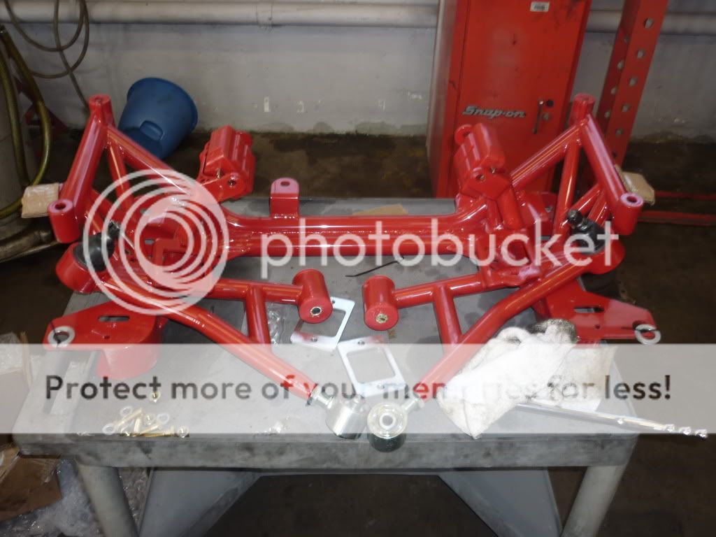

    Today we have here the mighty UMI Road Race K-member along with Upper and Lower Arms.
    Obviously already installed lol

    [IMG]http://i535.photobucket.com/albums/ee357/JT_Grooms/P1000637.jpg
    [/IMG]
