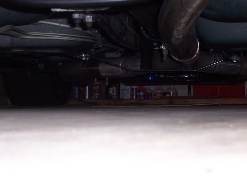

    Well i recently installed a UMI Tunnel Brace with Driveshaft Loop and for the record its great minus one thing... Its a bit low. And on a lowered car, Too low. Ive already scraped HARD on a few speed bumps around post. I mean Hard. Heres the product. Im only 1.2" lowered and still have Spring Isolators in.
    This thing sits lower than my left side of my ypipe. Any susgestions? I want a Sturdy Tunnel brace and i would like a loop too, but not at the cost of saftly driving on the streets. I love UMI stuff so dont get me wrong, just didnt know this thing sits so low. I wonder if some 1/2" BMR front Shock spacers will help. I hope I can keep on. Looks good though. Its a heavy duty piece.

    Apparently there are two types of DS loops they sell. I got the one for All Longtube setups but i think mine can run the one that sits up higher then this one. anyone with the other style DS loop (straight brace, not angled)?

    Well you've got the one that dips lower, for longtubes I believe. What did you expect? If it wasn't lower than your y pipe, it wouldn't fit. Prolly should have gotten this one.

    I think the one you guys have will fit with mine. The one i have dip way to far. Theres alot of room between the exhuast and Brace. I not running kooks but i think it will work. Heres a pic right before install of TA and DS loop. I think the other one will clear.

    My current ground clearance. I think i can fit the other brace and loop.

    From the pics, looks like the other style should work fine.
    Thas what im thinking. My system tucks up under the car pretty good so from the pictures I think the other one can fit. If anything a shim or two might have to be used to give it some space.
    +1. If it was really close anyway with the other one, a couple of washers between the ds lop and the floor of the car would give enough clearance no doubt.

    Agreed. Just make sure to re-set your pinion angle with the new unit as it may be positioned differently. On our car, I had to lop off the upper parts of the plates that are bolted onto each side of the front torque arm mount. I have a PST driveshaft and it was simply way too close for comfort.
    Ouch! That's just way too little ground clearance for a street ride. Great for the track or strip, though.
