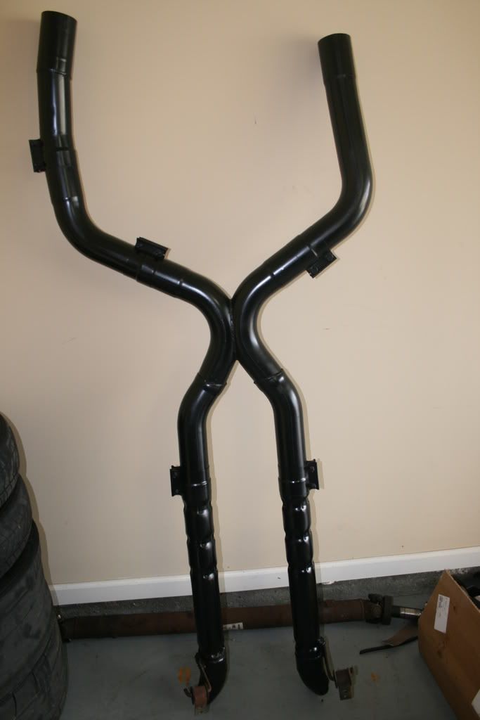

i have them but i have not put them on yet...
bought them for $300 new, never installed...
